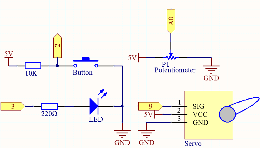

Schematic
../_images/circuit_515_eeprom.png
Wiring
../_images/eeprom_servo.png
  • Open the 5.15.eeproom.ino file under the path of 3in1-kit\basic_project\5.15.eeproom.
  • Or upload the code through the Arduino Web Editor.
To use this circuit, you simply press the button to begin recording and input the desired information through a potentiometer. Now, the board will repeat your actions endlessly (and it blinks an led each iteration) until you press the button again to record new actions. You may also vary the amount of time recorded by changing the values of resolution and recordTime.
