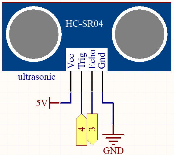

Schematic
../_images/circuit_6.3_ultrasonic.png

About the application of ultrasonic sensor, we can directly check the subfunction.
float readSensorData(){// ...}
The trigPin of the ultrasonic module transmits a 10us square wave signal every 2us
digitalWrite(trigPin, LOW);
delayMicroseconds(2);
digitalWrite(trigPin, HIGH);
delayMicroseconds(10);
The echoPin receives a high level signal if there is an obstacle within the range and use the pulseIn() function to record the time from sending to receiving.
microsecond=pulseIn(echoPin, HIGH);
The speed of sound is 340 m/s or 29 microseconds per centimeter.
This gives the distance travelled by the square wave, outbound and return, so we divide by 2 to get the distance of the obstacle.
float distance = microsecond / 29.00 / 2;
