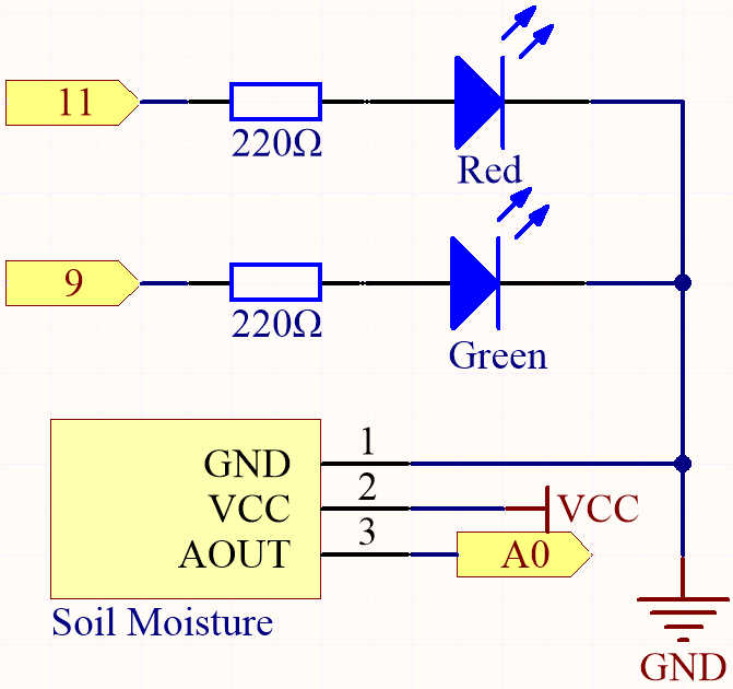

Schematic
../_images/circuit_8.2_threshold.png
Wiring
../_images/threshold_bb.png
  • Open the 5.2.threshold.ino file under the path of 3in1-kit\basic_project\5.2.threshold.
After the code is uploaded successfully, if your threshold is set correctly, you will see the red LED light up when the soil is dry to remind you that you need to water; after watering, the green LED will light up.
