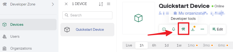

  2. Click the devices page and you will see the new device you just created. Then, click developer tools.
    ../../_images/blynk_copy_developer.png
