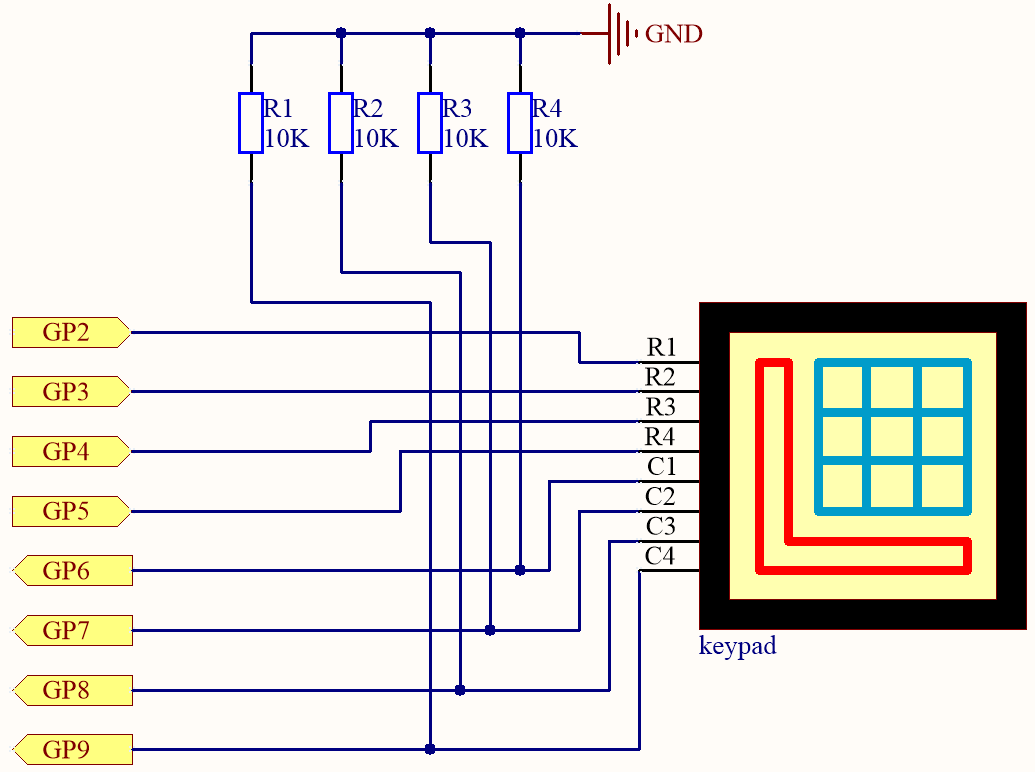

Schematic
sch_keypad
4 pull-down resistors are connected to each of the columns of the matrix keyboard, so that G6 ~ G9 get a stable low level when the keys are not pressed.
The rows of the keyboard (G2 ~ G5) are programmed to go high; if one of G6 ~ G9 is read high, then we know which key is pressed.
For example, if G6 is read high, then numeric key 1 is pressed; this is because the control pins of numeric key 1 are G2 and G6, when numeric key 1 is pressed, G2 and G6 will be connected together and G6 is also high.
Wiring
wiring_keypad
To make the wiring easier, in the above diagram, the column row of the matrix keyboard and the 10K resistors are inserted into the holes where G6 ~ G9 are located at the same time.
