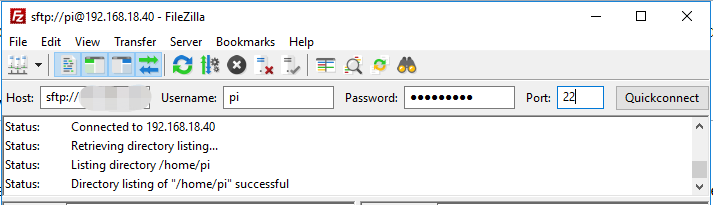

After a quick install open it up and now connect it to an FTP server. It has 3 ways to connect, here we use the Quick Connect bar. Enter the hostname/IP, username, password and port (22), then click Quick Connect or press Enter to connect to the server.

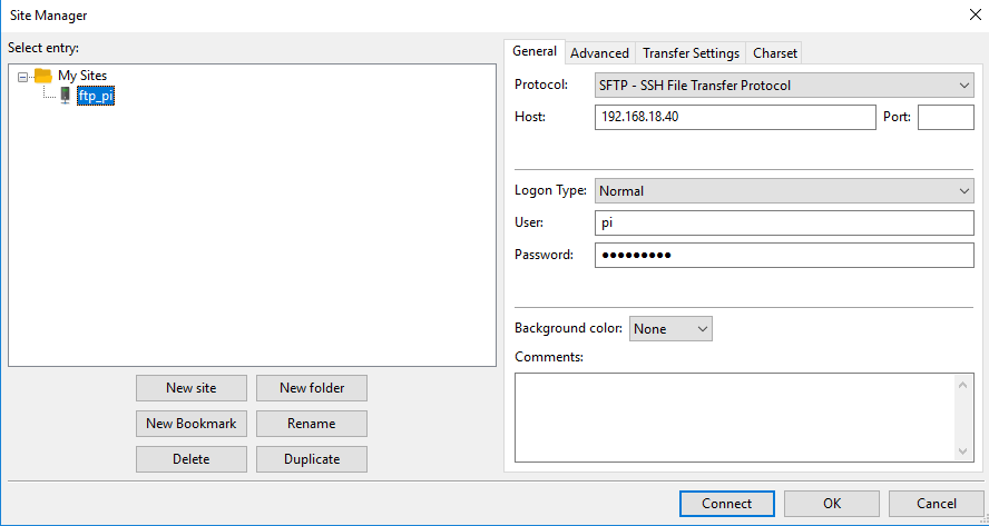

Quick Connect is a good way to test your login information. If you want to create a permanent entry, you can select File-> Copy Current Connection to Site Manager after a successful Quick Connect, enter the name and click OK. Next time you will be able to connect by selecting the previously saved site inside File -> Site Manager.

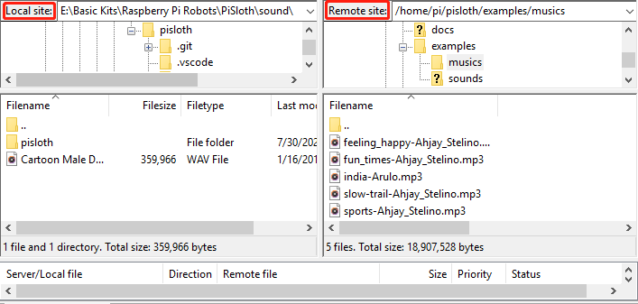

You can upload local files to Raspberry Pi by dragging and dropping them, or download the files inside Raspberry Pi files locally.
