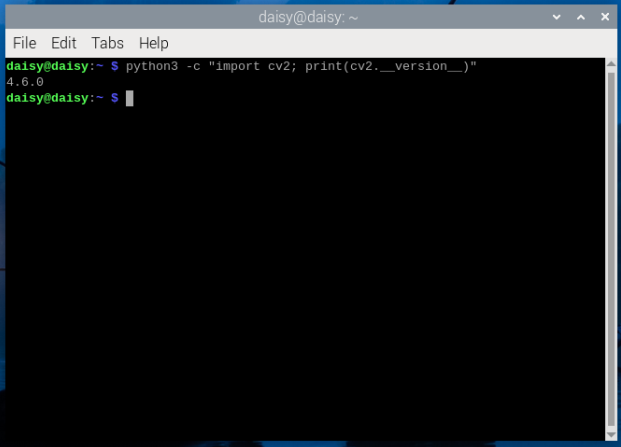

  6. Run the command below to verify that OpenCV has been installed successfully:
    python3 -c "import cv2; print(cv2.__version__)"
    If the OpenCV version number is displayed, the installation was successful.
    ../_images/install_opencv_check_version.png
