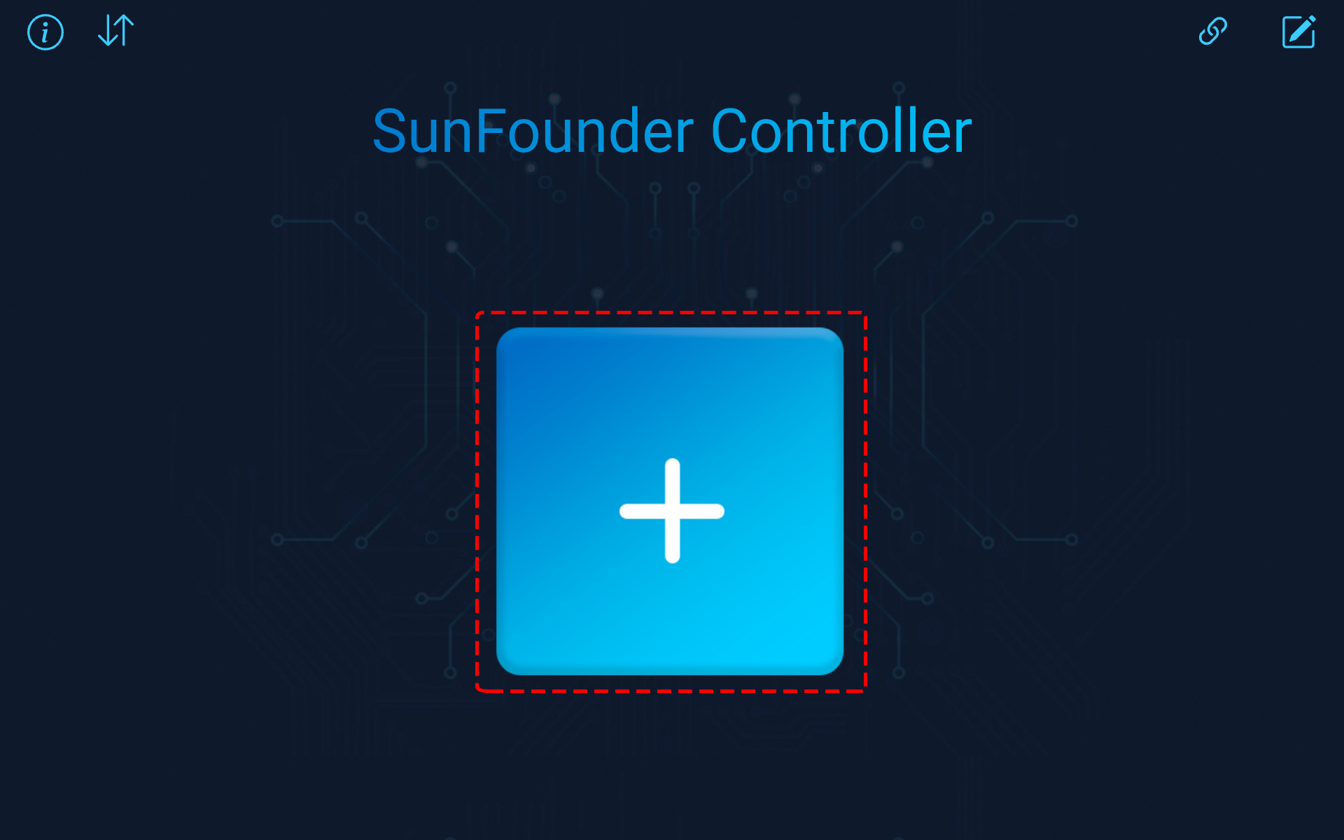

  7. Create a controller.
    • To add a controller on SunFounder Controller, click the + icon.
    ../_images/app1.png
