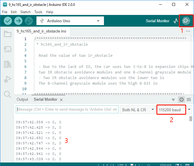

  2. Open the 9_hc165_and_ir_obstacle.ino file under the path of zeus-car-main\examples\9_hc165_and_ir_obstacle.
  3. After the code is uploaded successfully, slide the power switch to ON to start the Zeus Car.
    Do not unplug the USB in this step, because you need to check the data of the two obstacle avoidance modules on your computer.
  4. Open the serial monitor and make sure the current baud rate is set to 115200, then you can view the printed data.
    • If both obstacle avoidance modules do not detect an obstacle, the serial monitor will print 0, 0.
    • Put your hand in front of one of the obstacle avoidance modules, it will print 1, 0 or 0, 1.
    ../_images/ar_serial.png
