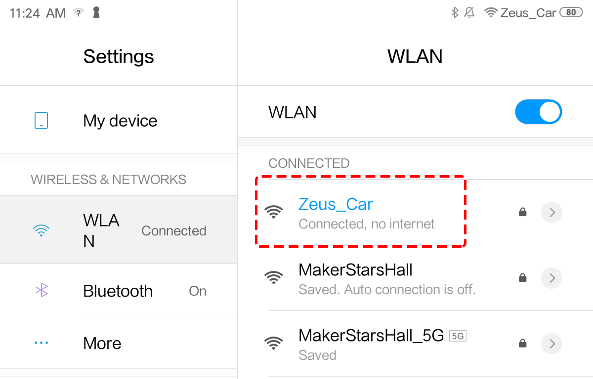

  7. Connect to Zeus_Car WLAN.
    • Find Zeus_Car on the WLAN of the mobile phone (tablet), enter the password 12345678 and connect to it.
    ../_images/app_wlan.png
    • The default connection mode is AP mode. So after you connect, there will be a prompt telling you that there is no Internet access on this WLAN network, please choose to continue connecting.
    ../_images/app_no_internet.png

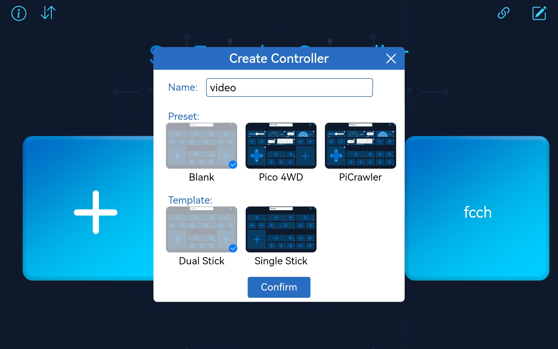

  8. Then open the APP and create a controller.
    • To add a controller on SunFounder Controller, click the + icon.
      ../_images/app1.png
    • Select the Blank and Dual Stick template and give it a name.
      ../_images/view_app1.jpg

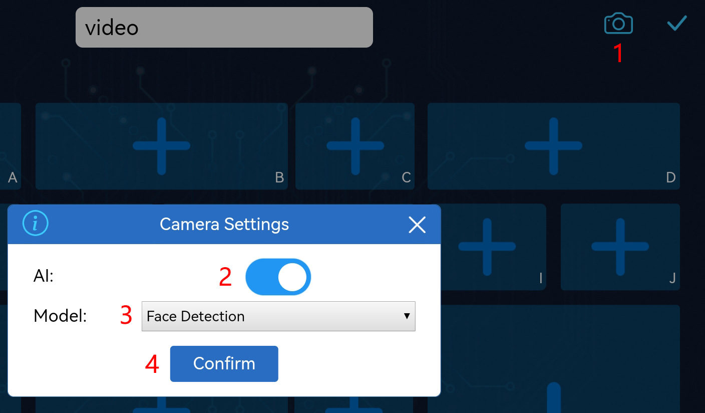

    • As you are now inside the controller, click the app_camera icon to enable the AI detection feature. You will find both Face Detection and Pose Detection options.
      ../_images/view_app6.jpg

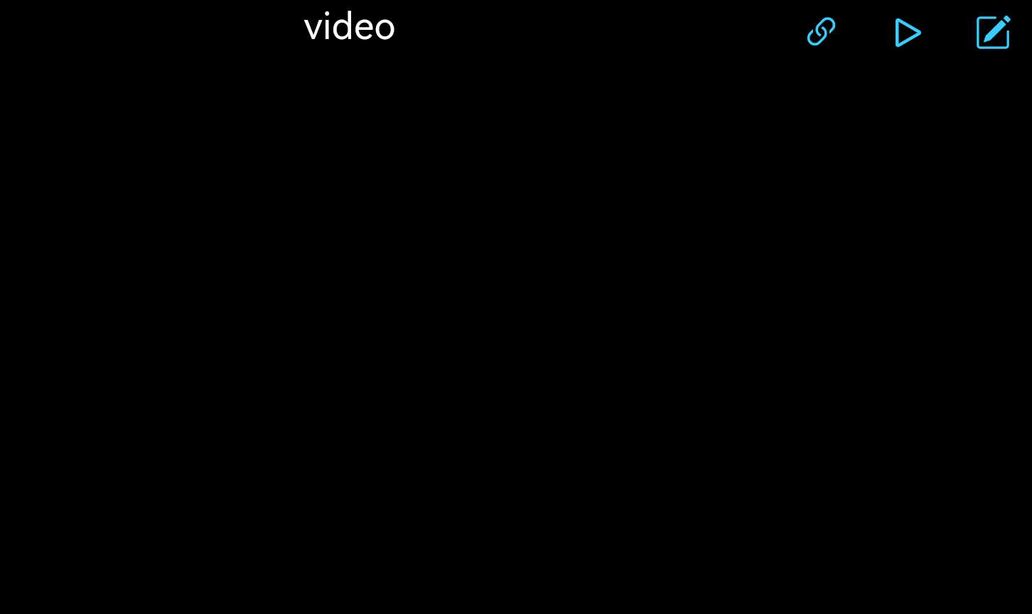

    • Save all settings by clicking on the app_save button. As no widgets have been selected, the screen is completely black.
      ../_images/view_app3.jpg

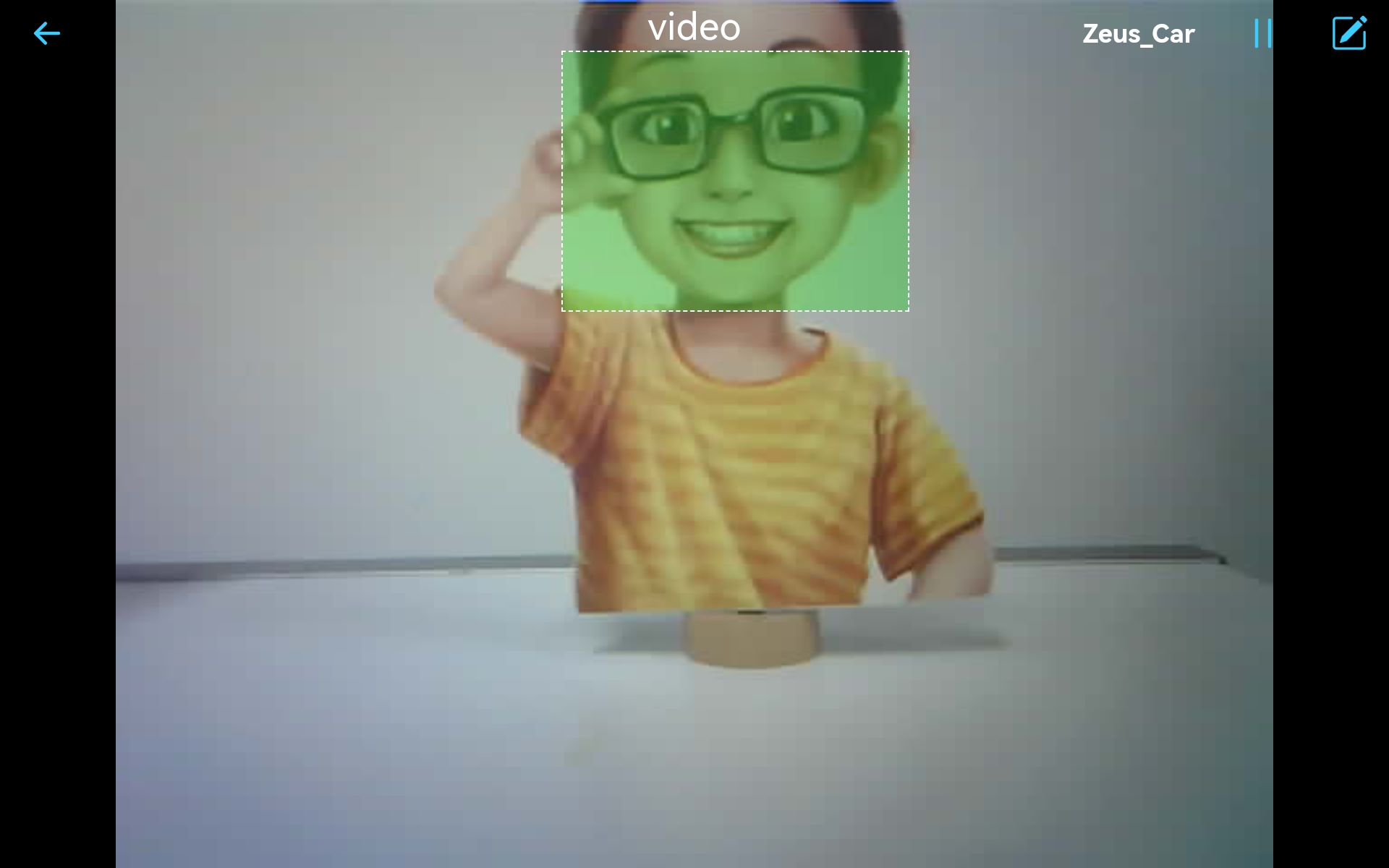

    After the “Connected Successfully” message appears, click the app_run button, then the camera footage will appear on the app.
    If you have Face Detection turned on, then the face that appears in the screen will be framed.
    ../_images/view_app7.jpg

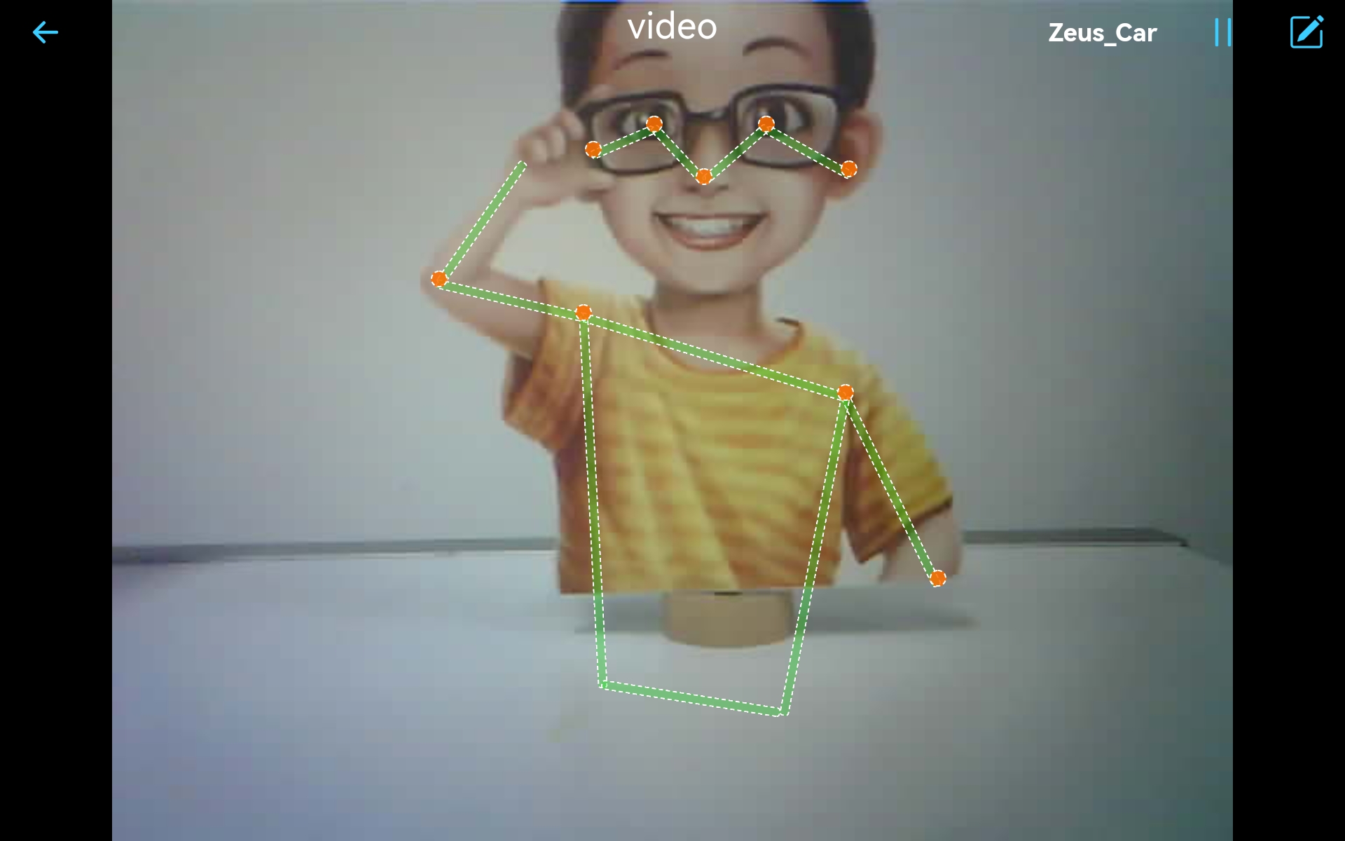

    If you have Pose Detection on, then the pose will be depicted.
    ../_images/view_app8.jpg
