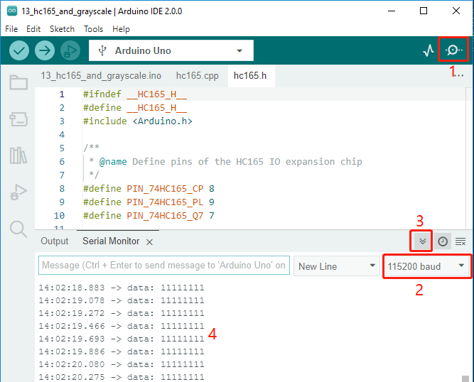

  4. Open the serial monitor and make sure the current baud rate is set to 115200. It is recommended to click on the Toggle Autoscroll icon so that you can see the latest printed data.
    ../_images/ar_grayscale.png
    • Turn the car over and you will be able to see the Serial Monitor print out data: 11111111.
    • If you cover one of the probes on the module with your hand, you will see the value in the corresponding position change to 0.
    • For example, if you cover the U11 probe, you will see data: 01111111.
