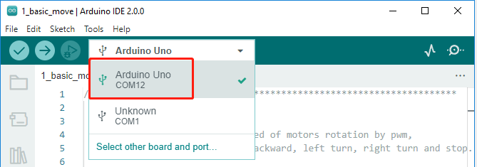

  2. Connect the Zeus Car to your computer with the blue USB cable. When you plug in your Arduino board, the computer automatically recognizes it and assigns it a COM port, which you can view in Device Manager.
  3. Open the 1_basic_move.ino file under the path of zeus-car-main\examples\1_basic_move.
  4. You can quickly select the board and port from this place.

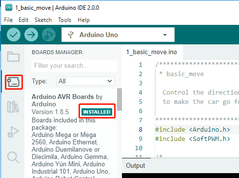

    In case COMxx doesn’t appear, open the Board Manager from the left and make sure the “Arduino AVR Boards” core is installed.
    ../_images/ar_other_board.png

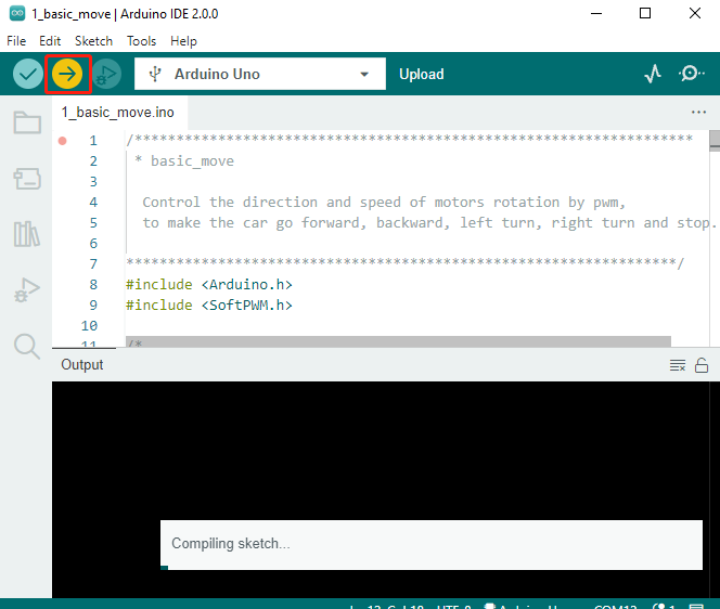

  5. Now click the Upload button to upload the code to the Arduino board. When it is finished, a notification pops up in the bottom right of your IDE window. Of course, sometimes there are some complications when uploading, and these errors will be listed here as well.
    • If you get a “Compilation error: SoftPWM.h: No such file or directory” prompt, it means you don’t have the SoftPWM library installed.
    • Please refer to Install the Required Libraries to install the two required libraries SoftPWM and IRLremote.
    ../_images/ar_upload.png

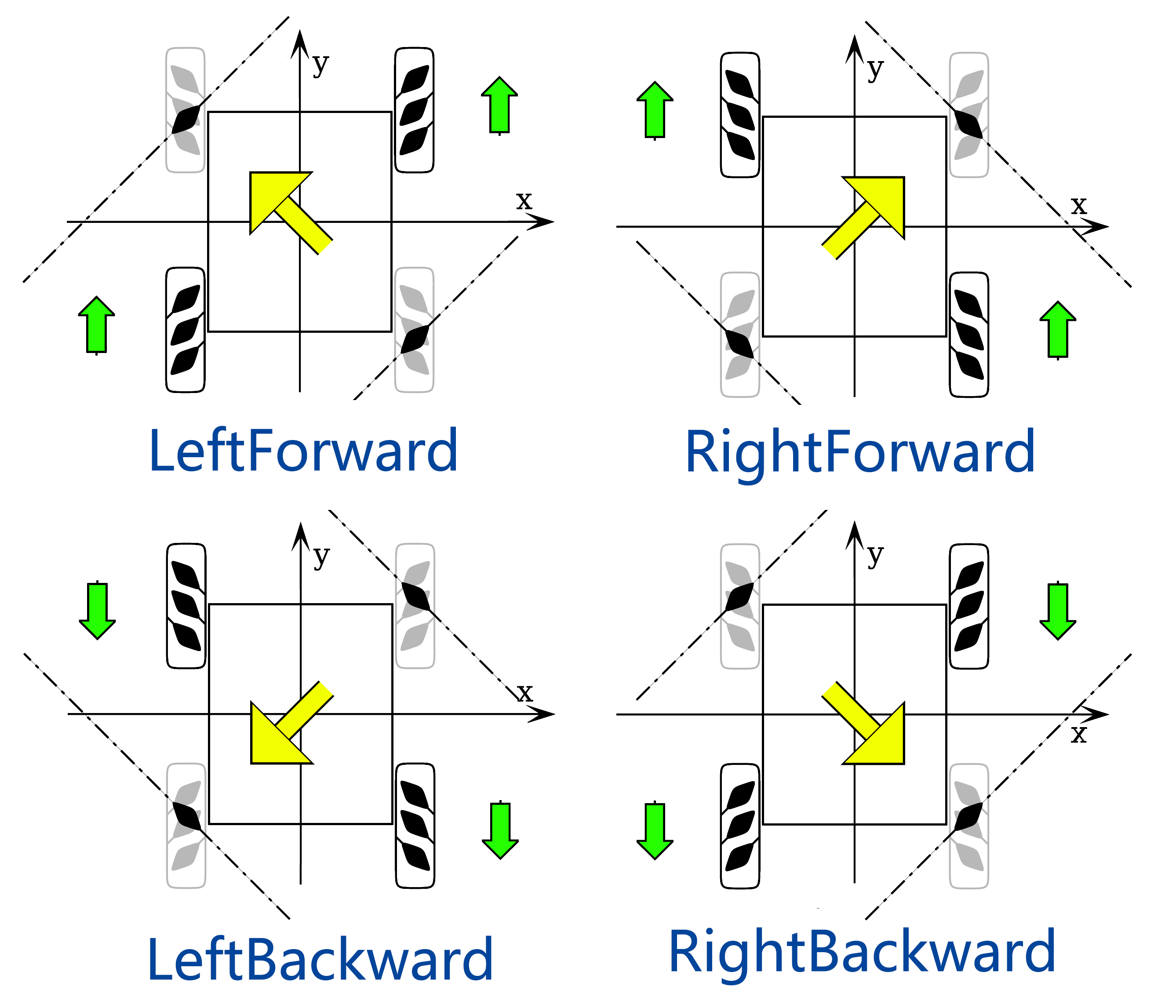

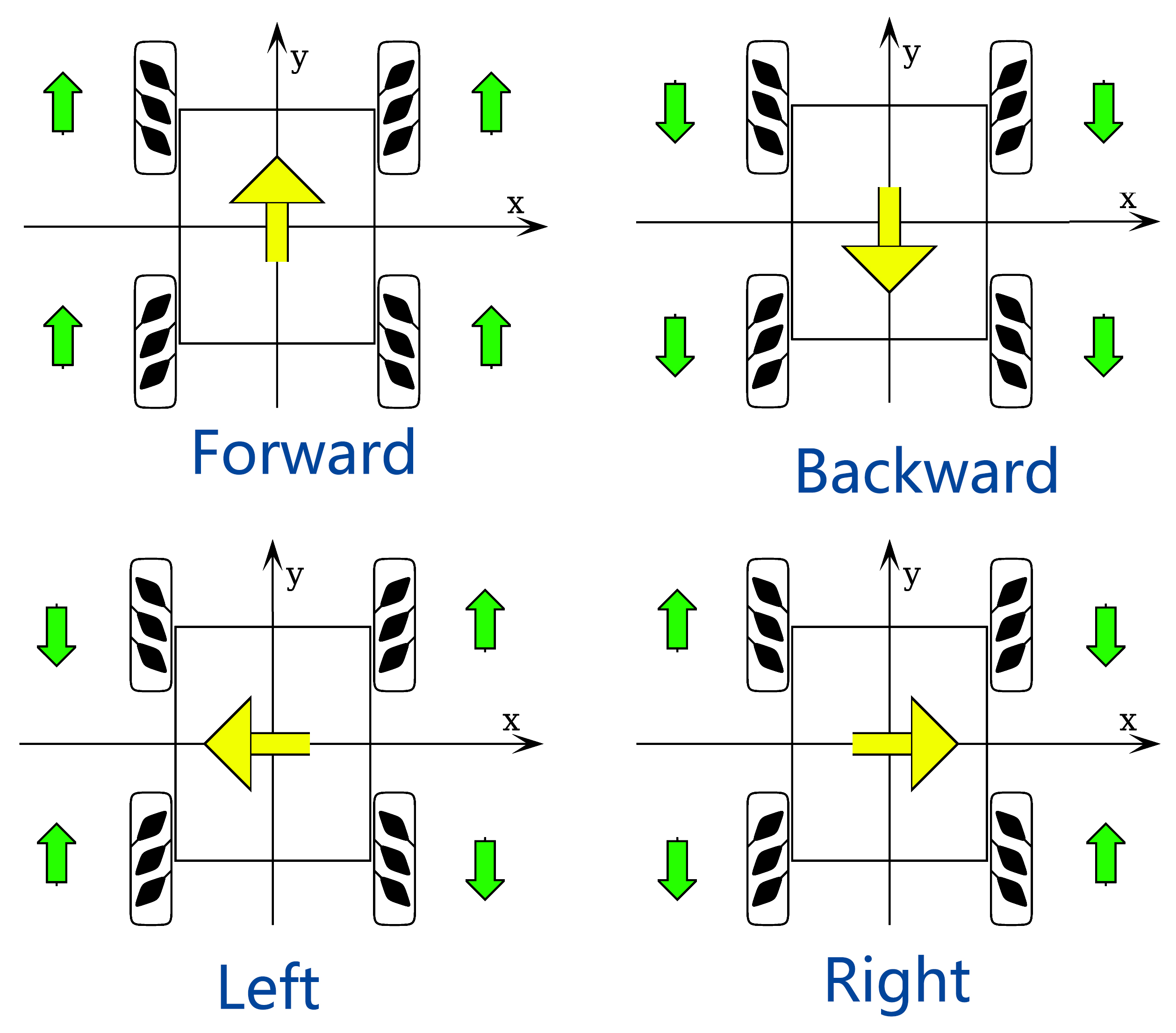

These movements are obtained by the 4 Mecanum Wheels cooperating together, for example, four wheels forward or backward at the same time can make the car also forward or backward, and two wheels forward and two wheels backward can cause the car to pan or rotate to the left or right.
Let’s look at how these movements are specifically achieved.
  • Moving forward and backward, panning left and right.
  • Diagonal panning
