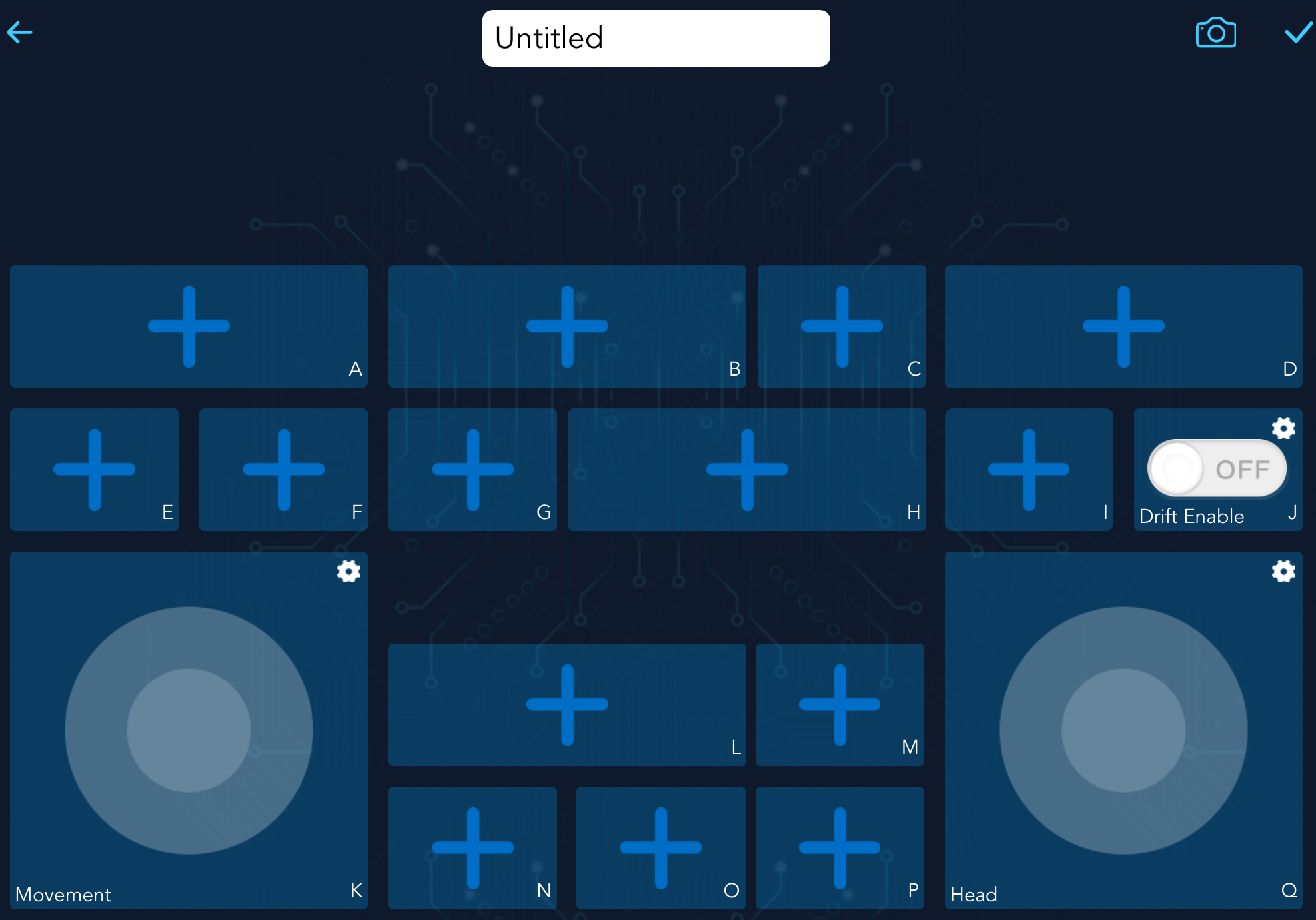

  7. Create a controller.
    • To add a controller on SunFounder Controller, click the + icon.
      ../_images/app1.png
    • There are preset controllers for some products in the Preset section. But here we choose a Blank and Dual Stick template.
      ../_images/app_blank.PNG
    • Click the + icon in the J area and select a Switch widget. You may need to slide to the left to see the widget.
      ../_images/app_switch_wid.png
      If you think you selected the wrong widget, you can click on it again and use the Delete button to remove it.
      ../_images/app_delete.png
    • Click the Settings icon in the upper right corner to give it a name.
      ../_images/app_name_dirft.png
    • Select a Joystick widget in the K and Q area and give name to both widgets. Then use the app_save button to save the controller.
    ../_images/app_joystick_wid.png

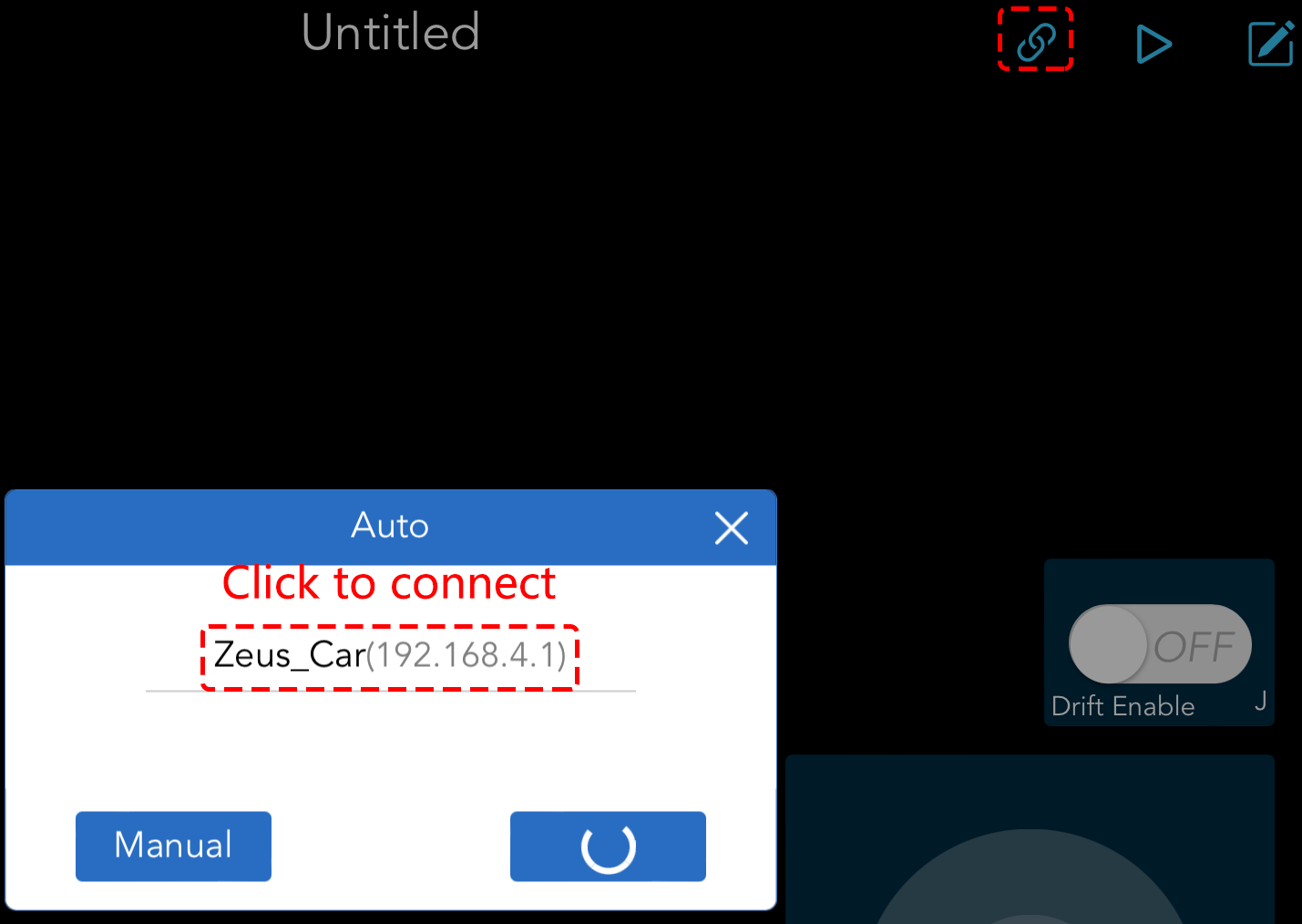

    • The next step is to connect the Zeus Car to your device via the app_connect button. Wait a few seconds and Zeus_Car(IP) will appear, click on it to connect.
      ../_images/app_connect.png
      Please make sure your Wi-Fi is connected to Zeus_Car, if you are not seeing the above message for a long time.
  8. Run the Controller.
    After the “Connected Successfully” message appears, click the app_run button, then the camera footage will appear on the app, and now you can control your Zeus Car with these widgets.
