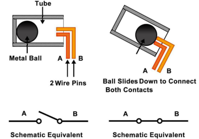

This is a ball tilt-switch with a metal ball inside. It is used to detect inclinations of a small angle.
Components
../_images/list_2.1.3_tilt_switch1.png
Principle
Tilt
The principle is very simple. When the switch is tilted in a certain angle, the ball inside rolls down and touches the two contacts connected to the pins outside, thus triggering circuits. Otherwise the ball will stay away from the contacts, thus breaking the circuits.

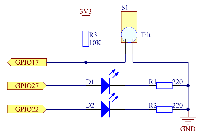

Schematic Diagram
../_images/image3071.png ../_images/image3081.png

Place the tilt horizontally, and the green LED will turns on. If you tilt it, "Tilt!" will be printed on the screen and the red LED will lights on. Place it horizontally again, and the green LED will turns on again.
