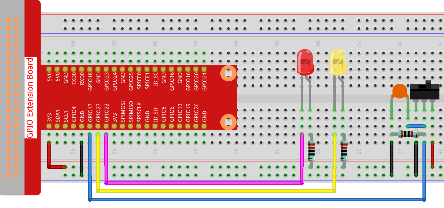

Connect the middle pin of the Slide Switch to GPIO17, and two LEDs to pin GPIO22 and GPIO27 respectively. Then when you pull the slide, you can see the two LEDs light up alternately.
../_images/image3051.png ../_images/image3061.png

Step 1: Build the circuit.
../_images/image1611.png

While the code is running, get the switch connected to the left, then the yellow LED lights up; to the right, the red light turns on.
