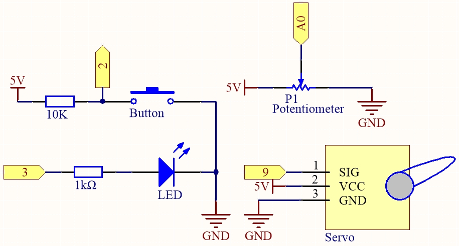

Schematic

To use this circuit, you simply press the button to begin recording and input the desired information through a potentiometer. Now, the board will repeat your actions endlessly (and it blinks an led each iteration) until you press the button again to record new actions. You may also vary the amount of time recorded by changing the values of resolution and recordTime.

accordingly.As soon as a button press is detected, then recording begins and the required information is entered via a potentiometer. Now the board repeats your action endlessly (and flashes an LED for each repetition) until you press the button again, recording a new action.
void loop() { if (recording == true) {//record for (int i = 1; i <= resolution; i++) { digitalWrite(ledPin, HIGH); //light status led int val = map(analogRead(A0), 0, 1023, 0, 180); EEPROM.write(i, val); //Serial.println(EEPROM.read(i)); myServo.write(val); delay(recordTime); } digitalWrite(ledPin, LOW); //turn off status led delay(1000);//give time for person recording = false; } else { for (int i = 1; i <= resolution; i++) {//playback if (digitalRead(buttonPin) == 0) {//stop playback and record new values recording = true; break; } int readval = EEPROM.read(i); myServo.write(readval); //Serial.println(readval); delay(recordTime); } digitalWrite(ledPin, HIGH); //show a new repeat delay(100); digitalWrite(ledPin, LOW); } }
Make the variable
recording
true when the button is pressed.When the variable
recording
is true, start recording the action in the memory range.Read the value of the potentiometer and map it to 0-180 to store it in EEPROM and control the rotation of the servo.
The LED lights up at the start of recording and goes off at the end.
Repeat the recorded action with a quick flash of the LED to remind you of a new repeat.
