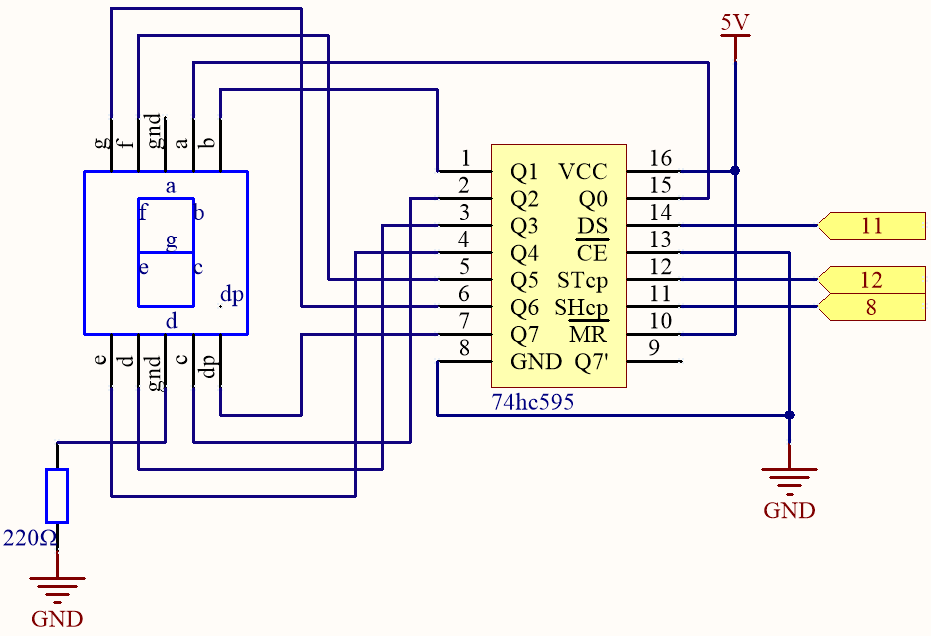

Schematic
../_images/circuit_6.5_segment.png
Wiring
Wiring
74HC595
LED Segment Display
Q0
a
Q1
b
Q2
c
Q3
d
Q4
e
Q5
f
Q6
g
Q7
dp
