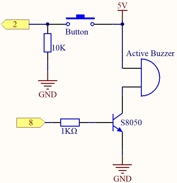

Schematic
../_images/circuit_8.6_interval.png
Wiring
../_images/5.13_interrupt_bb.png
  • Open the 5.13.interrupt.ino file under the path of 3in1-kit\learning_project\5.13.interrupt.
After the code is successfully uploaded, turn on the Serial Monitor and you will see an auto-incrementing number printed out every second. If you press the button, the buzzer will sound. The button-controlled buzzer function and the timing function do not conflict with each other.
