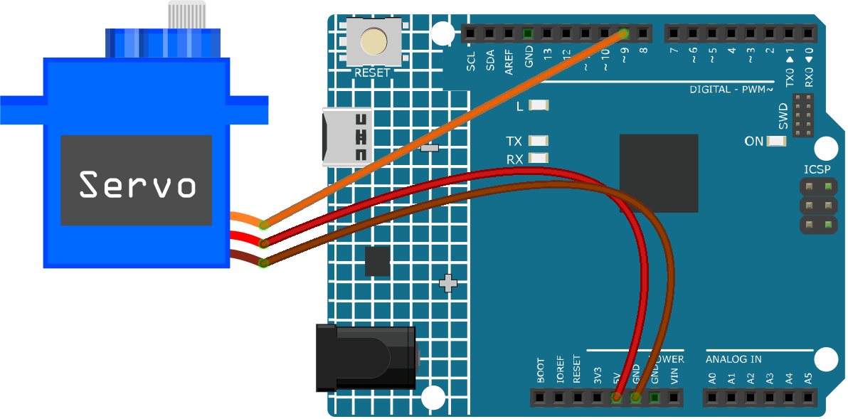

In this project, we use PWM pin 9 to drive the Servo, and get the orange wire of the servo connected to the PWM pin 9, the red one to 5V, and the brown one to GND.

../_images/5.5_swinging_servo_bb.png
  • Open the 5.5.use_internal_library.ino file under the path of 3in1-kit\learning_project\5.5.use_internal_library.
Once you finish uploading the codes to the R4 board, you can see the servo arm rotating in the range 0°~180°.
