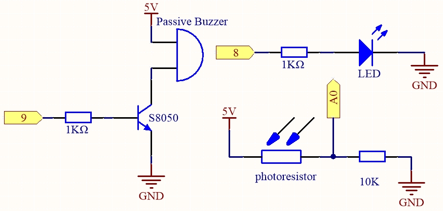

Schematic
../_images/circuit_8.8_calibration.png

  • Open the 5.14.calibration.ino file under the path of 3in1-kit\learning_project\5.14.calibration.
After the code is uploaded successfully, the LED will light up, and we will have 5 seconds to calibrate the detection range of the photoresistor. This is because we may be in a different light environment each time we use it (e.g. the light intensity is different between midday and dusk).
At this time, we need to swing our hands up and down on top of the photoresistor, and the movement range of the hand will be calibrated to the playing range of this instrument.
After 5 seconds, the LED will go out and we can wave our hands on the photoresistor to play.
