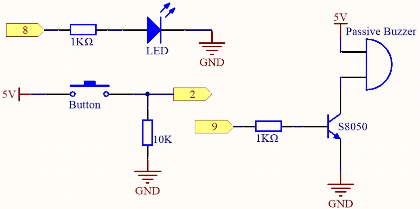

Schematic
../_images/circuit_8.5_interval.png
Wiring
../_images/5.4_interval_bb.png
  • Open the 5.4.interval.ino file under the path of 3in1-kit\learning_project\5.4.interval.
After the code is uploaded successfully, the buzzer will play music; whenever you press the button, the LED will light up. The work of LED and buzzer does not interfere with each other.
