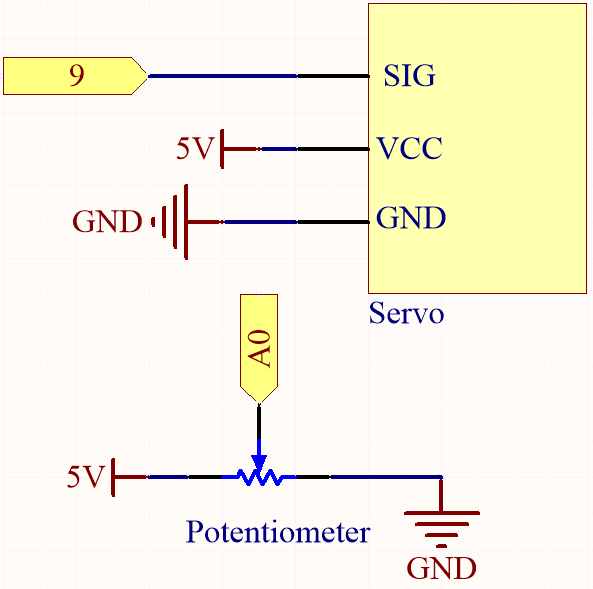

Schematic
../_images/circuit_8.3_amp.png
Wiring
../_images/5.6_map_bb.png
  • Open the 5.6.map.ino file under the path of 3in1-kit\learning_project\5.6.map.
After the code is uploaded successfully, you can rotate the potentiometer back and forth, and the output shaft of the servo will rotate back and forth.
