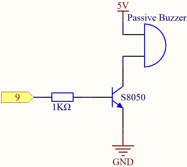

Schematic
../_images/circuit_6.1_passive.png

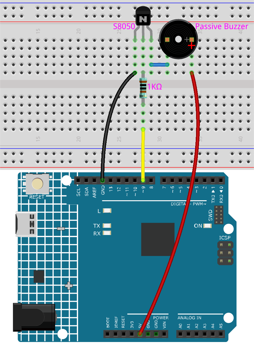

Connect the cathode of the Buzzer to GND, and the anode to the digital pin 9.
Wiring
../_images/5.7_tone_bb.png
  • Open the 5.7.tone_notone.ino file under the path of 3in1-kit\learning_project\5.7.tone_notone.
At the time when you finish uploading the codes to the R4 board, you can hear a melody containing seven notes.
