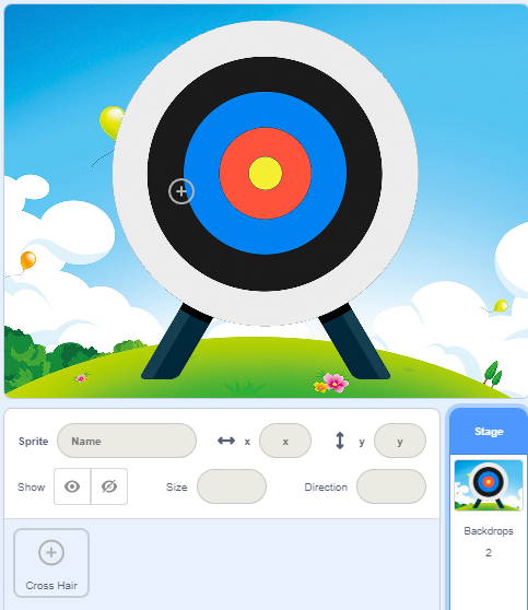

Arrange the Crosshair and targets.

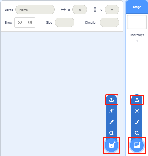

First, delete the previous sprite, upload the Crosshair sprite and the target background, you can find them under the path 10.1-touch-screen/scratch/materials (You have downloaded from github - 10.1-touch-screen before.).
Click the icon below the sprite list, select ā€œUpload Sprite Optionā€, find the Cross Hair.svg file, and upload it. Similarly, upload the backdrop, Target.jpg.
_images/shooting1.png _images/shooting2.png

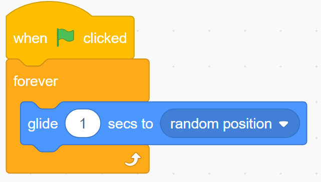

Let’s take aim.
When aiming, the Crosshair will slightly shake, we are now going to use the 怌glideā€¦ć€ block to achieve this effect.
_images/shooting3.png

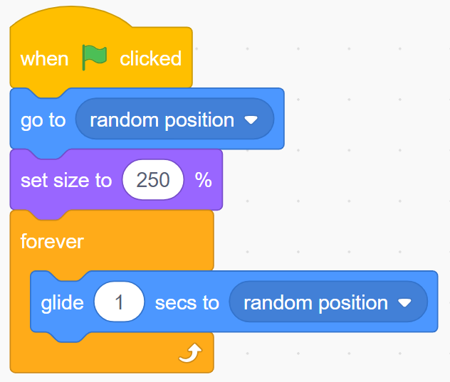

Set the random position and size of the Crosshair sprite.
_images/shooting4.png
Now, click on the green flag to see the effect of this aiming…very good. Let’s guess, change the time in the 怌glideā€¦ć€ block, will the front sight become more stable? Or is it more swaying?

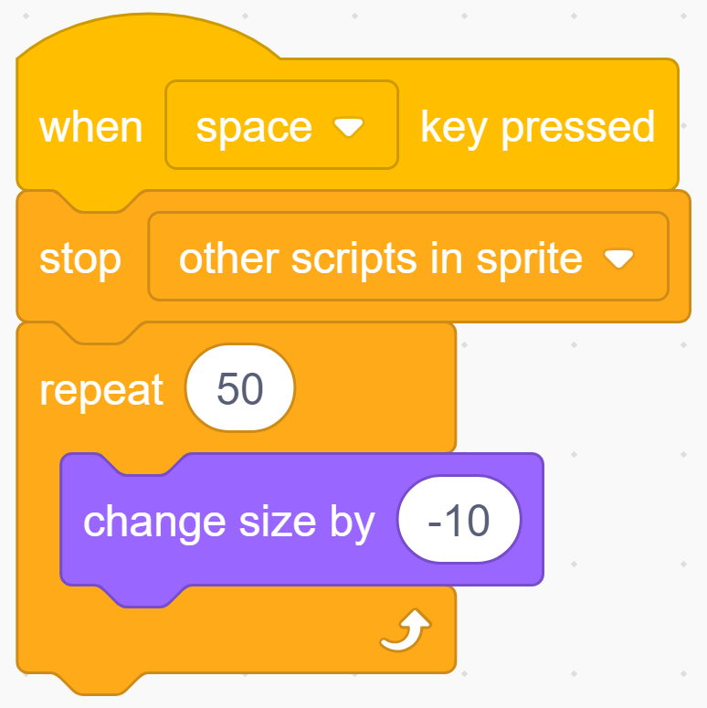

Let’s shoot!
We are now going to express the effect of shooting bullets.
how is it? Stop the crosshair moving, and then let it shrink quickly to create a shooting effect.
This means that when the space bar is pressed, we need to stop shaking the code of the Crosshair and keep the size of the Crosshair sprite shrinking.
_images/shooting5.png
Click the green flag to try the effect!

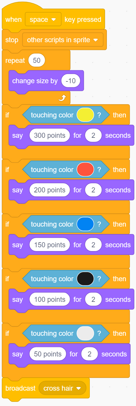

Calculate the score!

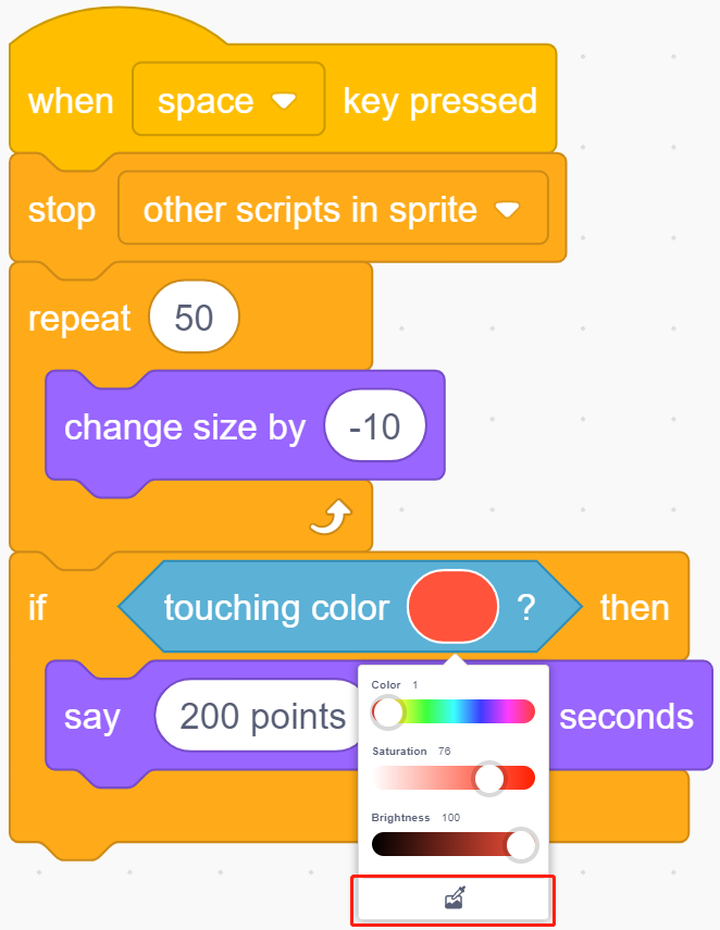

Then we need to establish a scoring mechanism. Shooting different color circles will get different scores. The closer to the bullseye, the higher the score.
For example, a shot in the red area can score 200 points. Let’s use the 怌Touching Color怍 block to judge. This block has a color picker, and we use it to pick up the red color on the target.
_images/shooting6.png
Use the same method to set corresponding scores for different color circles.
_images/shooting7.jpg
