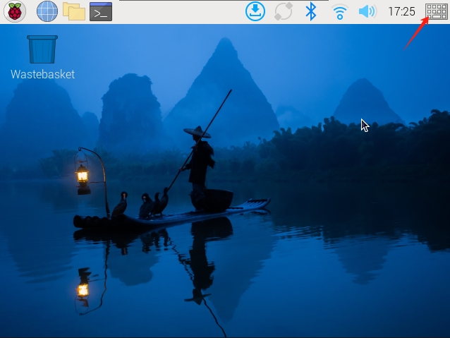

Raspberry Pi OS Bookworm and later include the Squeekboard on-screen keyboard by default. This keyboard automatically appears when text input is needed and hides when itβs not. For applications that do not support text entry detection, you can manually toggle the keyboard by clicking the keyboard icon at the right end of the taskbar.

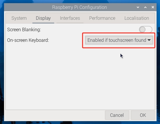

Alternatively, you can configure the on-screen keyboard to always show or hide via the Display tab in Raspberry Pi Configuration or the Display section of raspi-config.

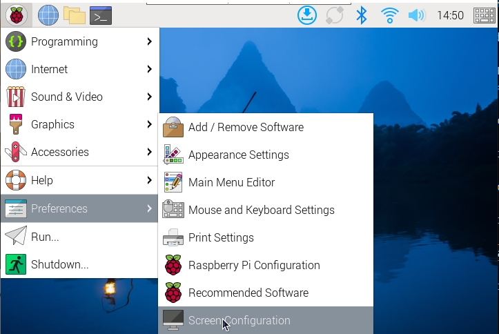

Click the Raspberry Pi icon -> Preferences -> Screen Configuration.

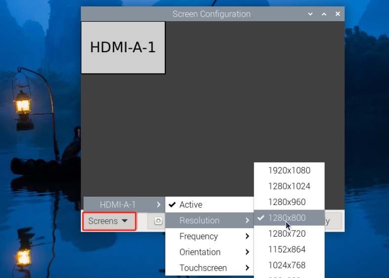

In the configuration menu, click the triangle icon at the bottom left corner, select HDMI-A-1 -> Resolution, and choose your desired resolution.

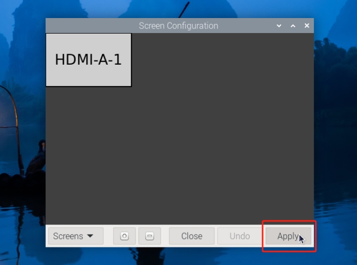

Finally, click Apply -> OK to save and apply the changes.

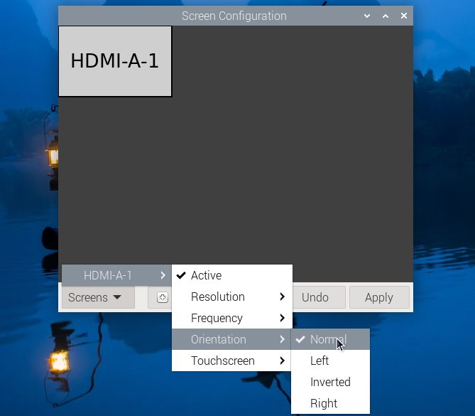

In the layout editor, right-click the touch display rectangle (usually labeled HDMI-A-1), select Orientation, and choose the desired option.
Click Apply -> OK to apply the changes.
