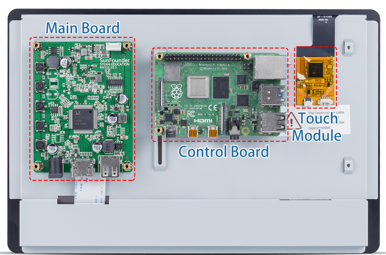

  • Main Board: It is mounted on top to control the display.
  • Control Board: It is a cross slot structure with one side movable, so you can mount different size of control board.
  • Touch Module: This is the module used to let the display get the touch function, you need to connect it to the USB port of the control board through the USB cable provided by us.

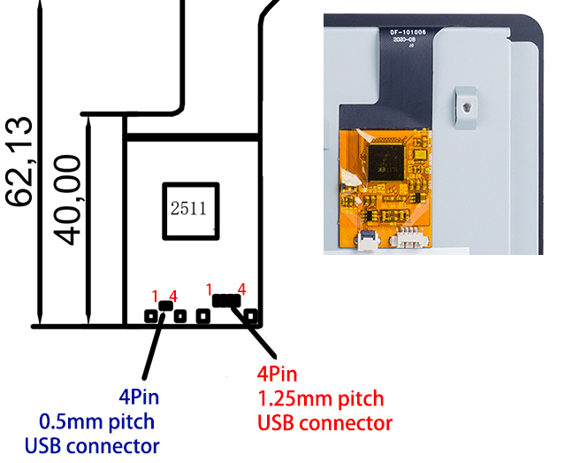

Touch Module
_images/touch_module.jpg
There are two types of 4pin connector on the touch module, with the pin serial number shown on the figure.
Here are the definitions of the pins:
  • Pin 1: VDD(5V)
  • Pin 2: D-
  • Pin 3: D+
  • Pin 4:GND

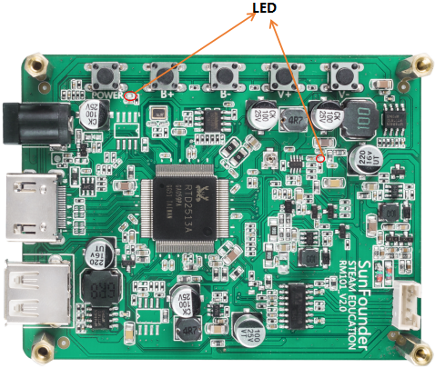

LED Indicators
_images/inch2.png
There are 2 LED indicators on the main board of the screen to show different signals:
  • Power on the screen, after the green LED flashes one time, it lights on continuously; and the red LED lights on immediately.
  • If there’s no HDMI signal, only the red LED will turn on.
  • If there’s an HDMI signal, these two LEDs will turn on.
  • If you press the power button, the green LED will turn off and the red LED will keep turning on.
  • If you remove the power cord, both of the two LEDs will turn off.

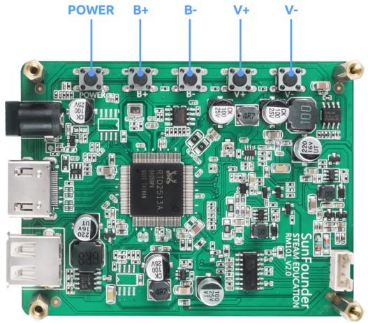

Buttons
Buttons on the main board and their functions:
_images/inch3.png
Power: Short press to switch ON/OFF(go into the sleep mode) the screen. Long press to power ON/OFF the device(Raspberry Pi).
  • B+: Increase screen brightness.
  • B-: Reduce screen brightness.
  • V+: Volume up.
  • V-: Volume down.

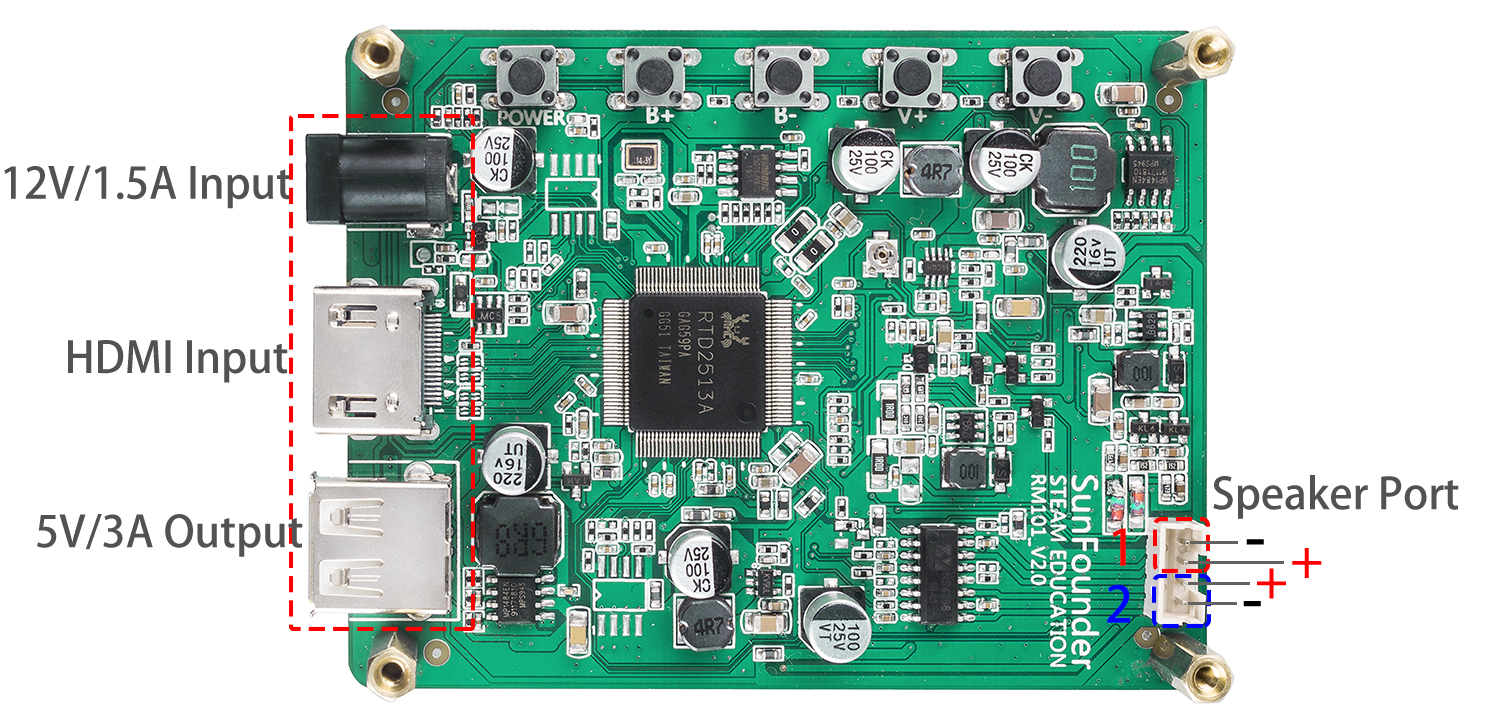

Interfaces
On one side of the main board there are ports of HDMI input, 12V power input, and 5V/3A USB power output. Also equipped with a 4pin PH2.0 speaker port.
