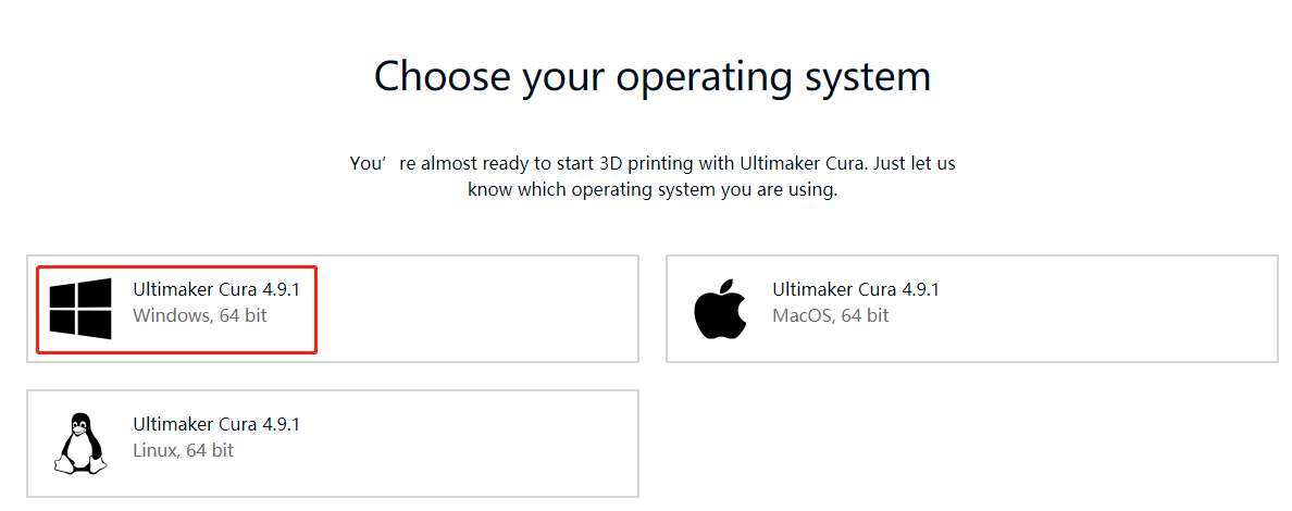

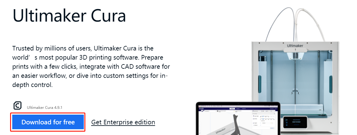

Download Ultimaker Cura. Since Ultimaker Cura is not available on the Raspberry Pi system, you need to perform the slicing operation on your computer.
Select the version you need.

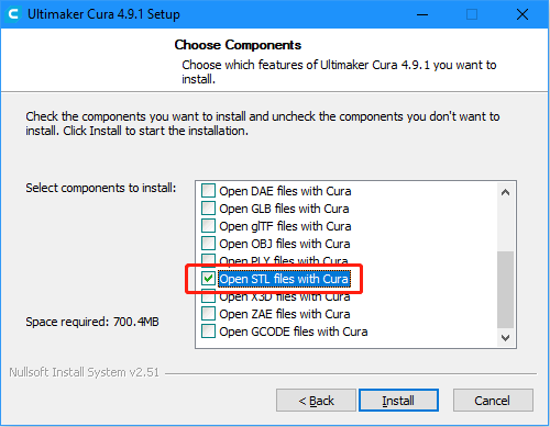

When installing Ultimaker Cura, please note that in the choose components step, Open STL files with Cura has been checked by default, so that .stl files can be sliced.
If you want to slice other types of model files, check the corresponding option, otherwise you can install it directly.

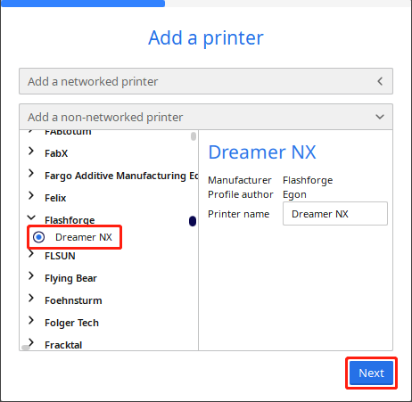

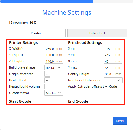

When opening Ultimaker Cura for the first time, there will be a series of configuration prompts. At the Add a Printer step, select the model of printer used and click Next.
After selecting the correct printer model, verify that the parameters provided by Ultimaker Cura in the Machine Settings page are correct, or change the parameters directly.

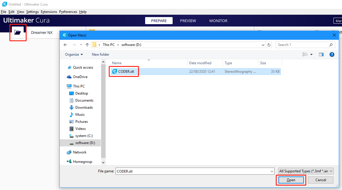

Once Ultimaker Cura has successfully launched, click the Folder icon in the upper left-hand corner and browse to the folder with the .stl 3D model file that needs to be sliced, and click Open to add the .stl file to Ultimaker Cura’s library.

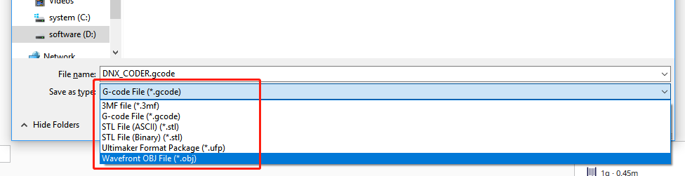

After slicing is complete, click the Save to Disk option in the lower right corner to save the sliced file locally.
Select the type of file extension recognized by the 3D printer, then click Save.

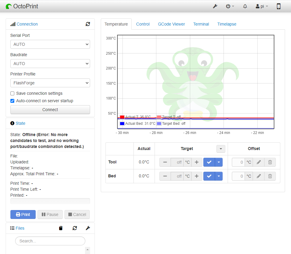

Open the Raspberry Pi’s browser, and enter http://192.168.18.179/?#temp to log in to OctoPrint.
Before logging in to the OctoPrint’s web UI, OctoPrint will first need to have been successfully installed on the Raspberry Pi.

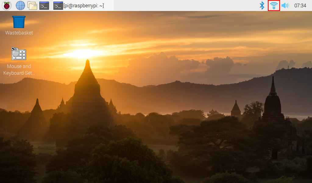

The IP address 192.168.18.179 will need to be replaced with the local IP address of the Raspberry Pi. Hover the cursor over the WiFi icon on the Raspberry Pi desktop, and the local IP address will be displayed.
Now you have entered OctoPrint.

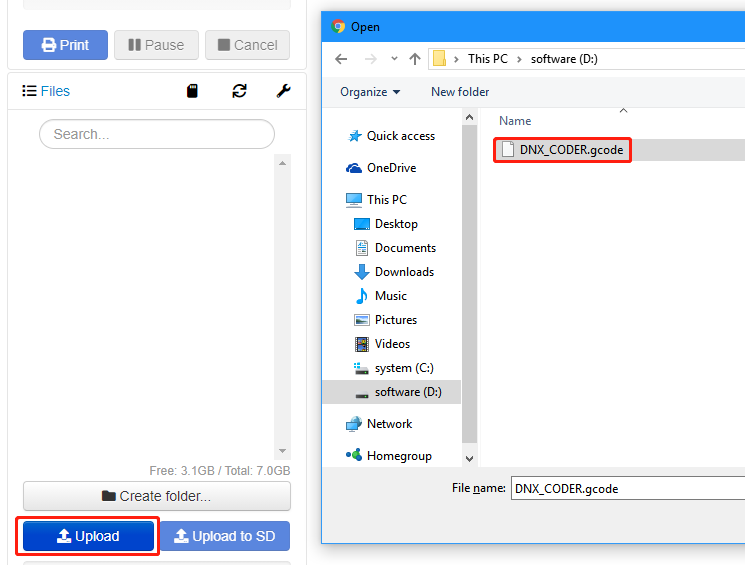

Click the Upload option to select the sliced 3D model file.

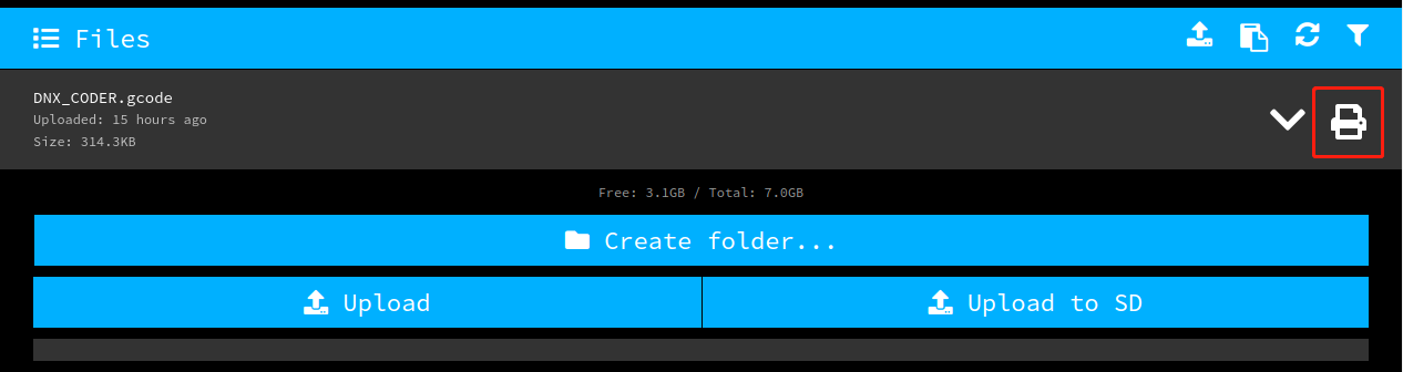

Click the print icon. The 3D printer will start to print the 3D model file after the slicing process is complete.
