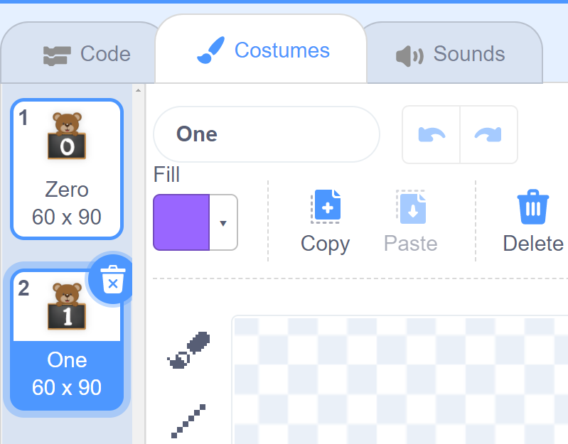

Then we upload the One.png file in the Costumes option of the Zero sprite, so that the Zero sprite has Zero costume and One costume.

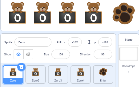

Then we copy the Zero sprite with the right mouse button, and there will be 3 new Zero sprites in the stage area.
_images/binary2.png

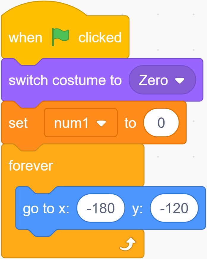

Set the default costume of the four sprites to Zero, record with the variables “num1”, “num2”, “num3”, and “num4” respectively, and initialize the positions of the four sprites.
The program in the figure below is the program of the Zero sprite. The other three Zero sprites modify the variable names and increase the X coordinate by 80 to make the effect arranged in order from left to right.

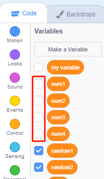

When we click the √ sign in front of the variable, the variable will disappear from the stage.
_images/binary4.png

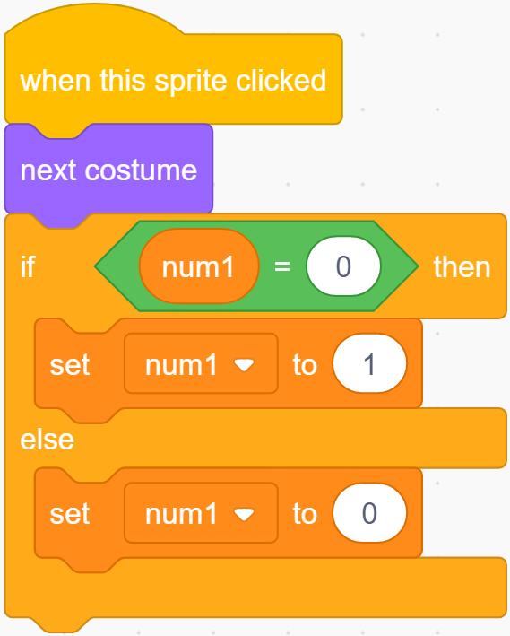

Change the shape by clicking and record the binary value.
If you click the Zero sprite, it will switch its costume to the next costume, and switch the value of the variable num1, if num1 = 0, change num1 to 1.
In this way, the num1 variable can record the value on the blackboard in real time every time the Zero sprite switches costume.
Copy the program for the remaining three Zero sprites and modify the variable names.

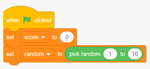

When the game starts, a random integer between 1-16 appears in the middle of our screen as a decimal number that needs to be converted by binary, and it is stored in the variable random.
_images/binary8.png

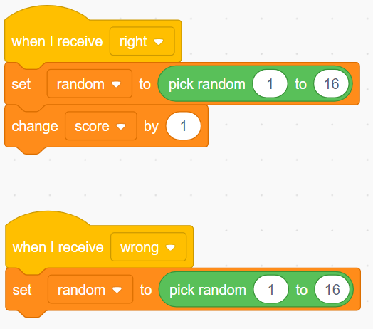

Whether we receive a “right” result or a “wrong” result, we have to regenerate the random number and proceed to the next round of the game.
_images/binary9.png

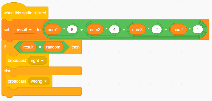

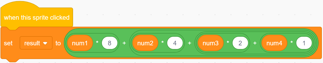

First, we create a result variable, when the Enter sprite is clicked, We convert the binary number composed of the num1 variable, num2 variable, num3 variable and num4 variable into a decimal number, and save the result in the result variable.
_images/binary10.png
Then use the result variable to compare the value of the random variable. If they are equal, we broadcast a “right” message, otherwise we broadcast a “wrong” message.
_images/binary11.png
