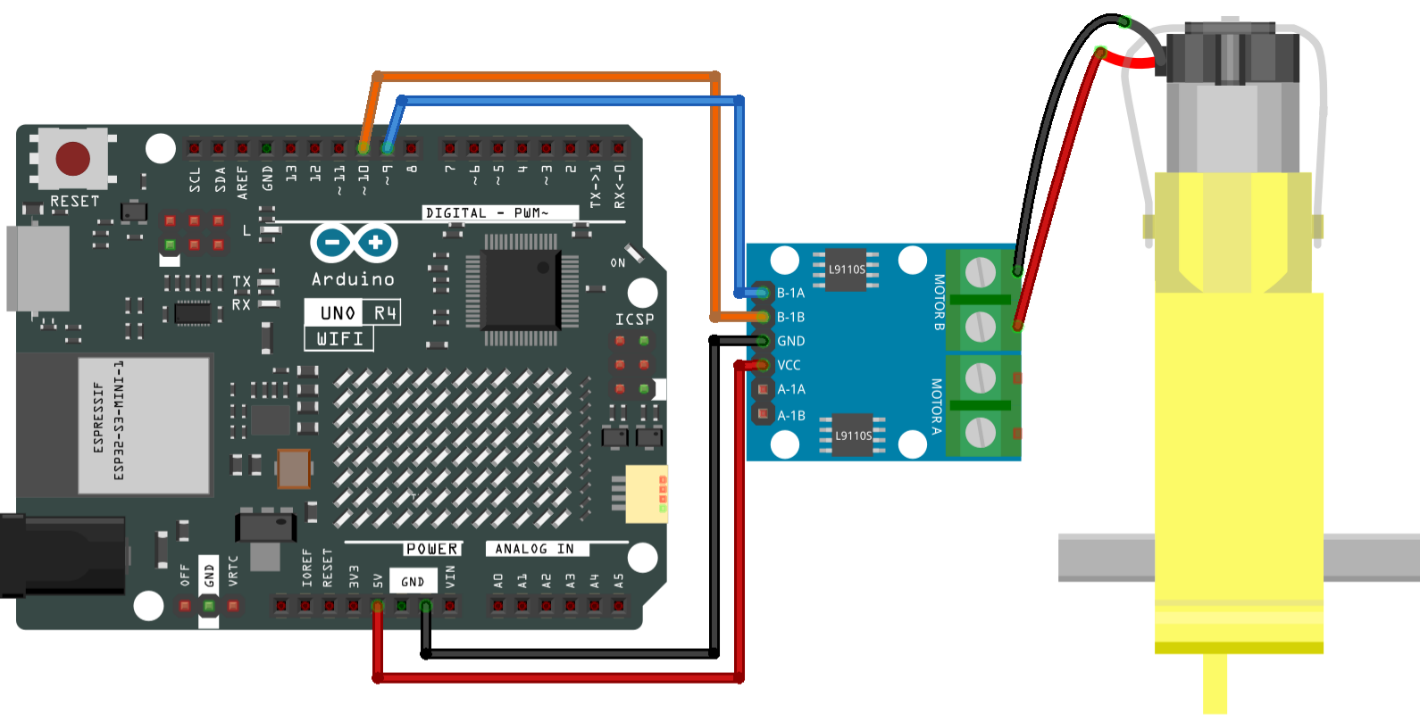

Wiring
../_images/20_TT_Motor_bb.png
Common Connections:
  • TT Motor
    • Connect to MOTOR B on the L9110 Motor Driver Module.
  • L9110 Motor Driver Module
    • GND: Connect to GND on the Arduino.
    • VCC: Connect to 5V on the Arduino.
    • B-1B: Connect to 10 on the Arduino.
    • B-1A: Connect to 9 on the Arduino.
