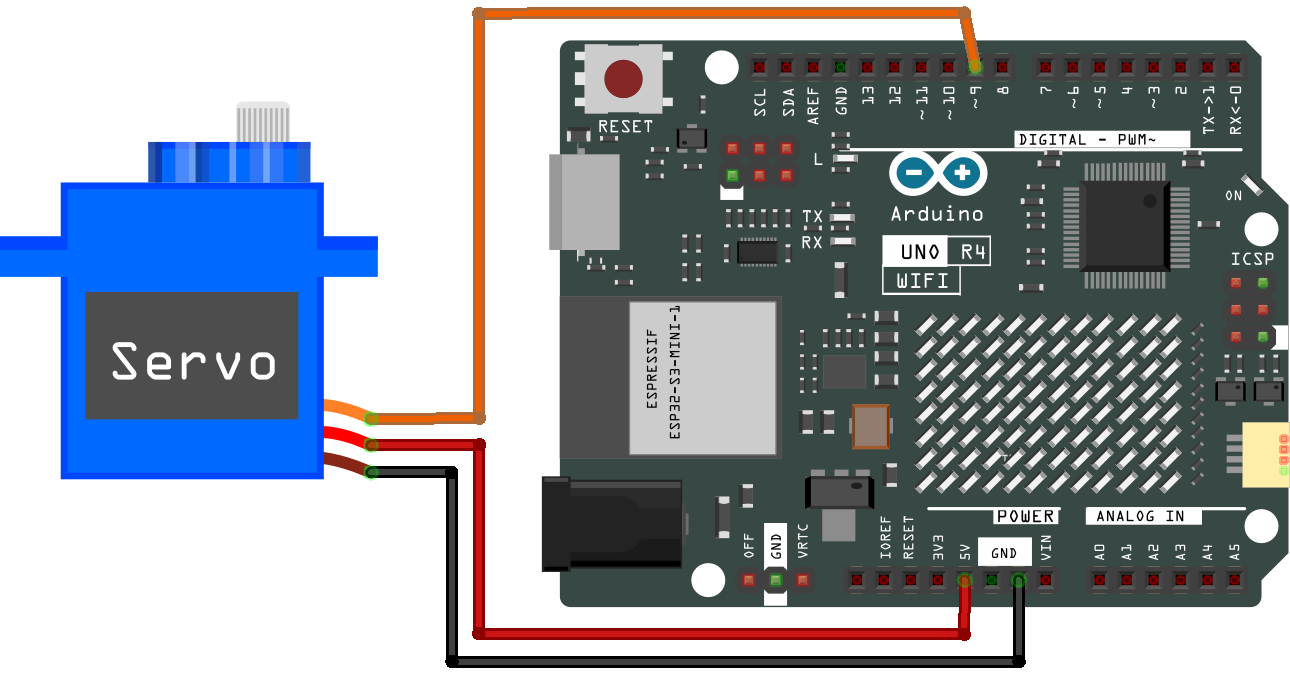

Wiring
../_images/02_Servo_Motor_bb.png
Common Connections:
  • Digital Servo Motor
    • GND: Connect to GND on the Arduino.
    • VCC: Connect to 5V on the Arduino.
    • I/O: Connect to 9 on the Arduino.
