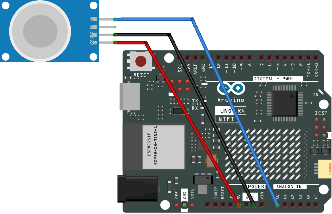

Wiring
../_images/10_MQ2_Module_bb.png
Common Connections:
  • MQ-2 Gas Sensor Module
    • A0: Connect to A0 on the Arduino.
    • GND: Connect to GND on the Arduino.
    • VCC: Connect to 5V on the Arduino.
