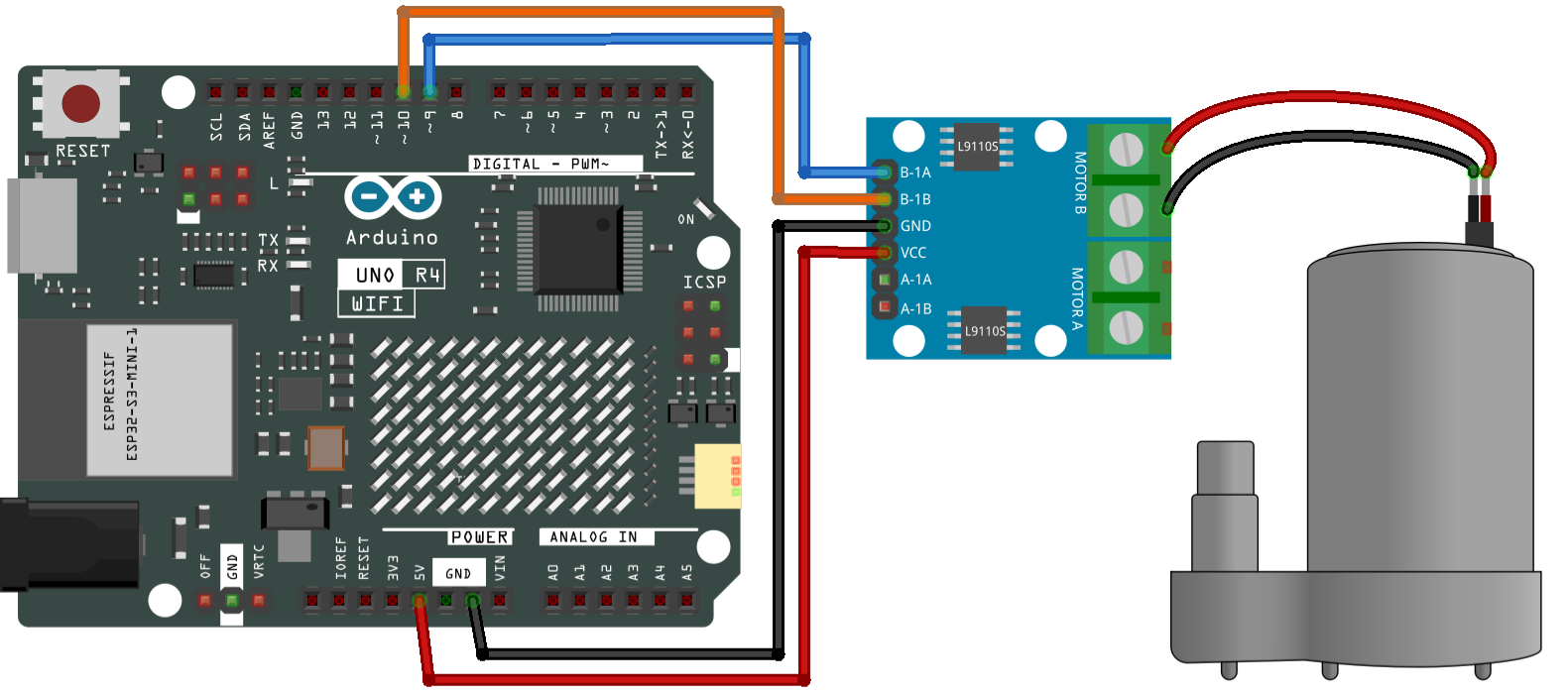

Wiring
../_images/21_Centrifugal_Pump_bb.png
Common Connections:
  • L9110 Motor Driver Module
    • GND: Connect to GND on the Arduino.
    • VCC: Connect to 5V on the Arduino.
    • B-1B: Connect to 10 on the Arduino.
    • B-1A: Connect to 9 on the Arduino.
  • Centrifugal Pump
    • Connect to L9110 Motor Driver Module Motor B.
