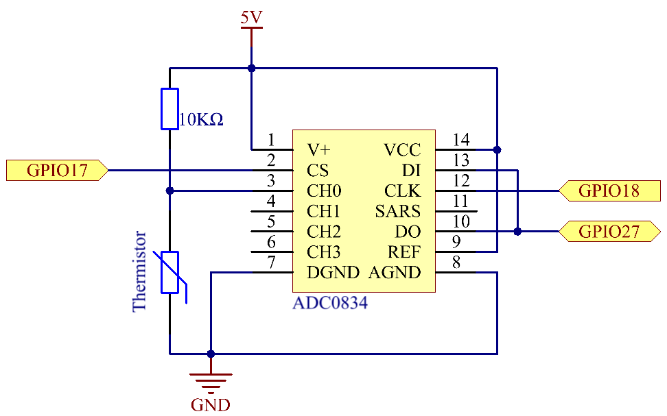

Schema Elettrico
../_images/2.2.2_thermistor_schematic_1.png ../_images/2.2.2_thermistor_schematic_2.png

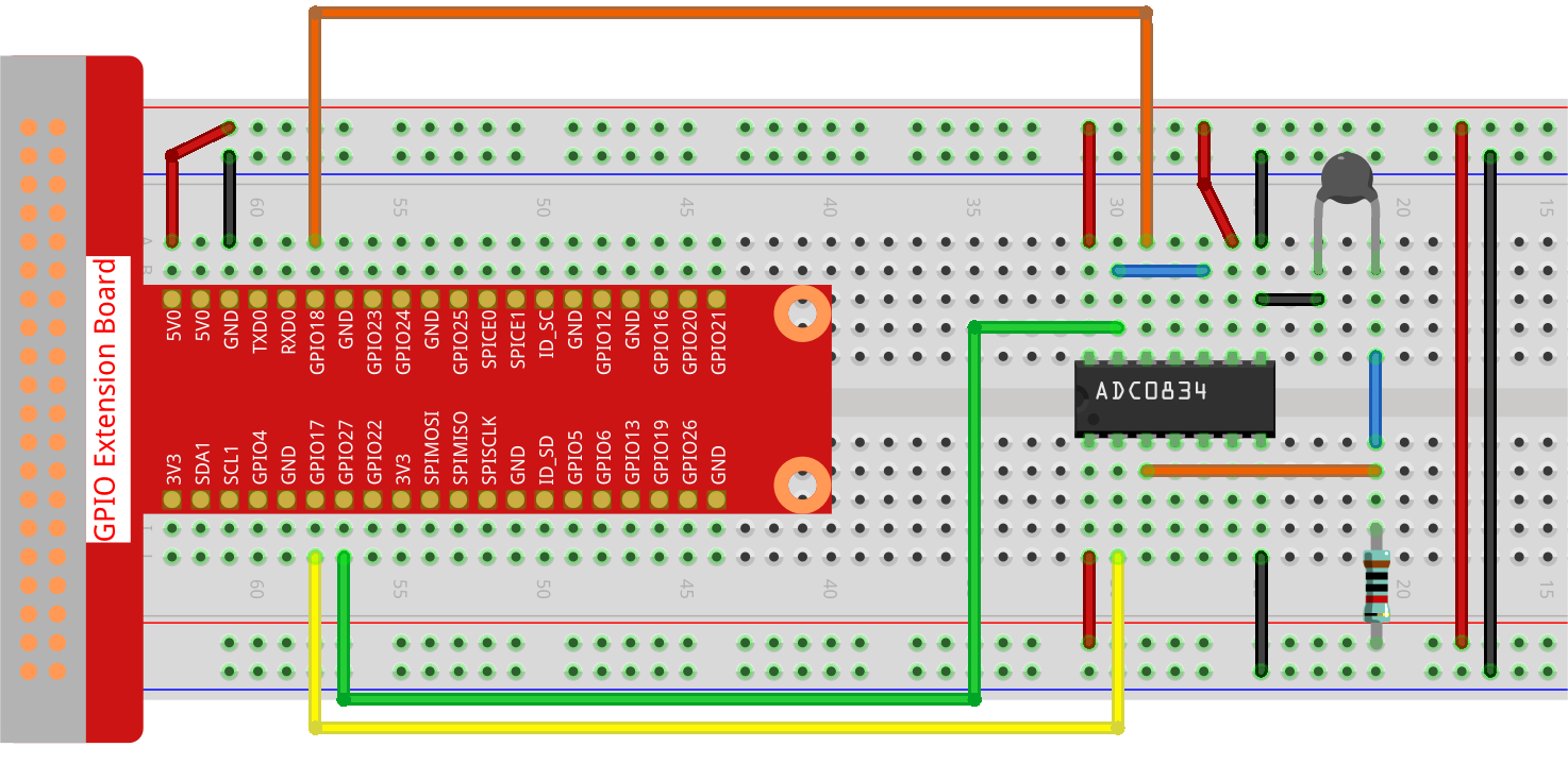

Procedure Sperimentali
../_images/2.2.2_thermistor_circuit.png
