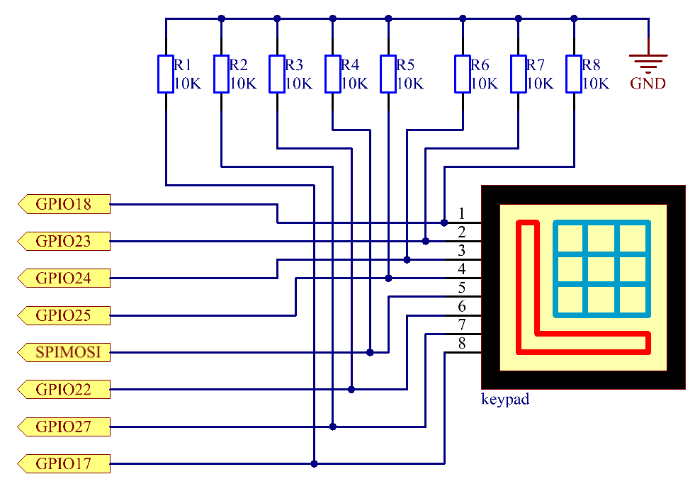

Schema Elettrico
../_images/2.1.8_keypad_chematic_1.png ../_images/2.1.8_keypad_chematic_2.png

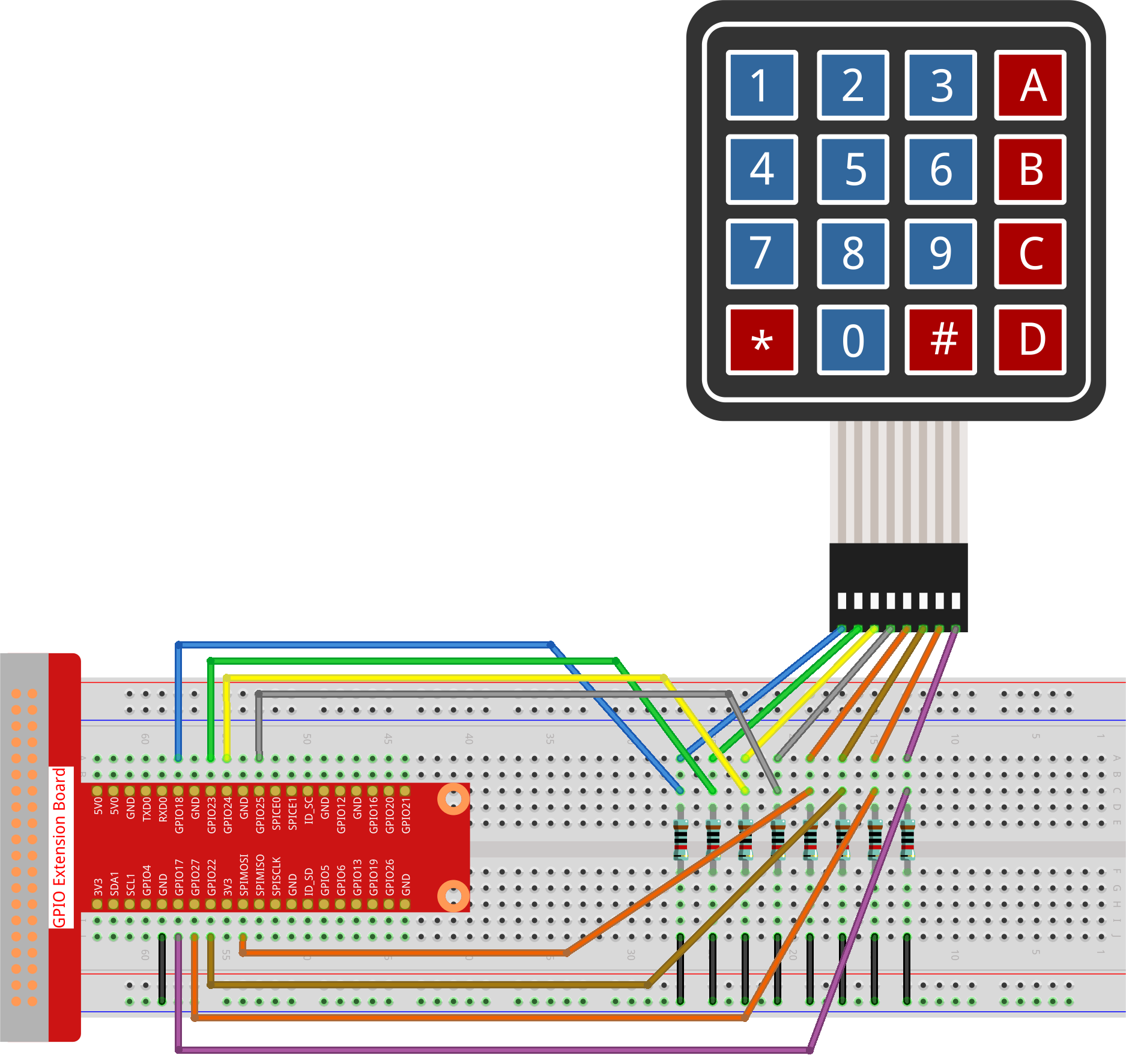

Procedure Sperimentali
../_images/2.1.8_keypad_circuit.png
