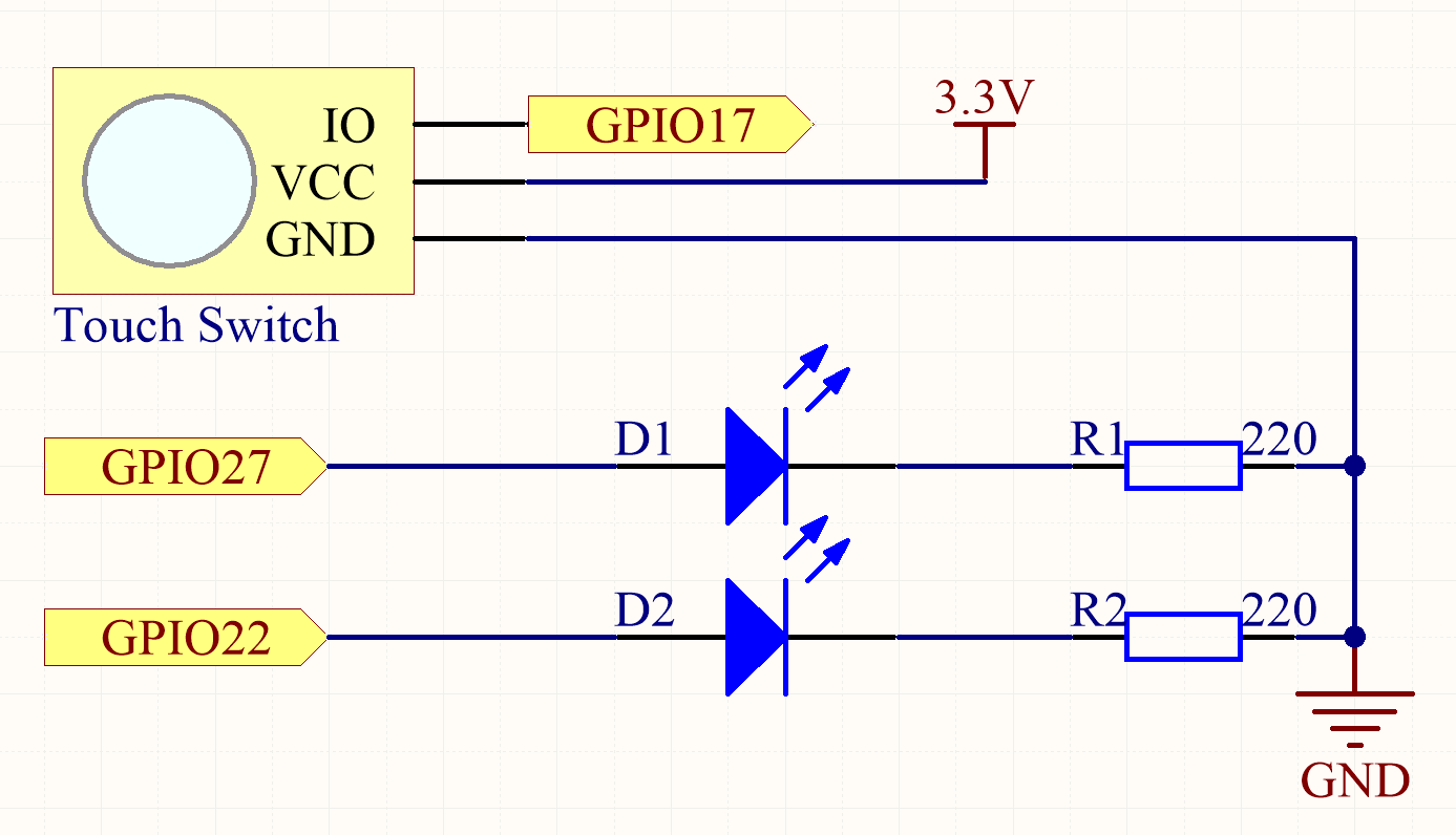

Schema Elettrico
../_images/2.1.3_touch_switch_schematic.png
