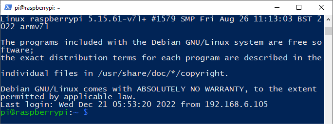

  6. We now get the Raspberry Pi connected and are ready to go to the next step.
    ../../_images/sp221221_140628.png

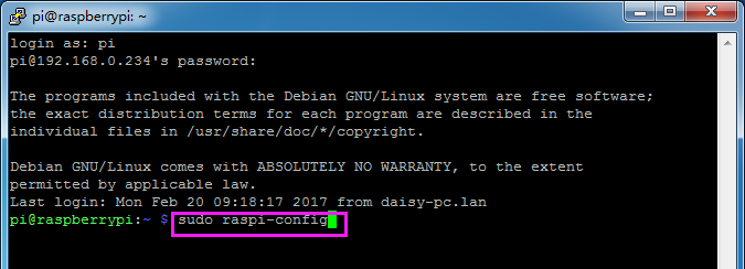

  1. Input the following command:
    sudo raspi-config
    ../../_images/image2871.png

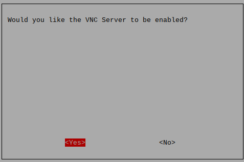

  4. Use the arrow keys on the keyboard to select <Yes> -> <OK> -> <Finish> to complete the setup.
    ../../_images/mac_vnc8.png

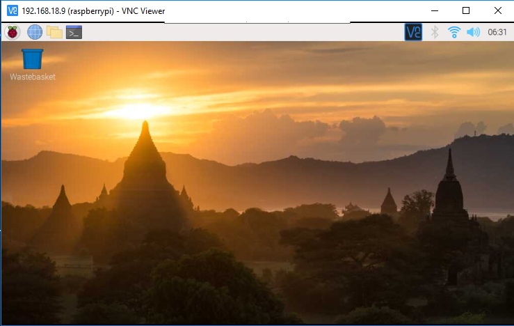

  4. Now you can see the desktop of the Raspberry Pi.
    ../../_images/image2941.png
