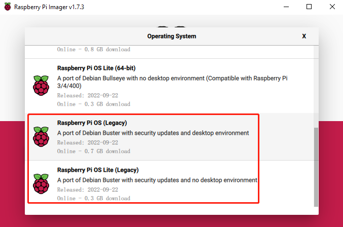

In the Raspberry Pi Imager, click CHOOSE OS -> Raspberry Pi OS(other).
../../_images/3d33.png
Scroll down to the end of the newly opened page and you will see Raspberry Pi OS(Legacy) and Raspberry Pi OS Lite(Legacy), these are security updates for Debian Buster, the difference between them is with or without the desktop. It is recommended to install Raspberry Pi OS(Legacy), the system with the desktop.
../../_images/3d34.png

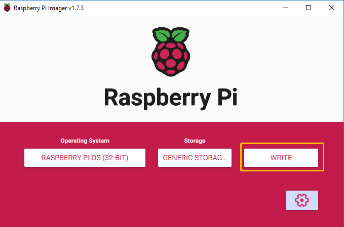

Step 7
Click the WRITE button.
../../_images/image17.png

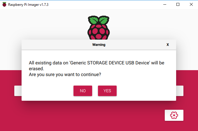

Step 8
If your SD card currently has any files on it, you may wish to back up these files first to prevent you from permanently losing them. If there is no file to be backed up, click Yes.
../../_images/image18.png

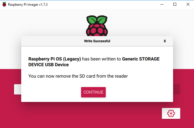

Step 9
After waiting for a period of time, the following window will appear to represent the completion of writing.
../../_images/image19.png
