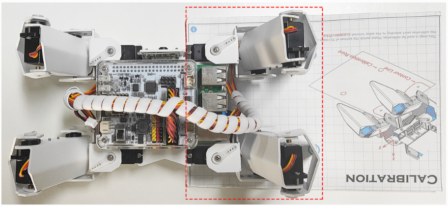

  1. Take out the assembly leaflet, turn it to the last page, and lay it flat on the table. Then place the PiCrawler as shown below, aligning its bottom with the outline on the calibration chart.
    ../../_images/calibration21.png

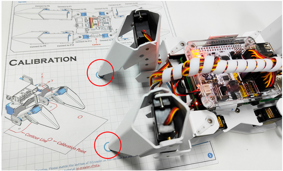

  3. Press 2 and 3 keys respectively to choose left 2 legs,then press w, a, s, d, r, and f keys to move them to the calibration point.
    ../../_images/calibration31.png

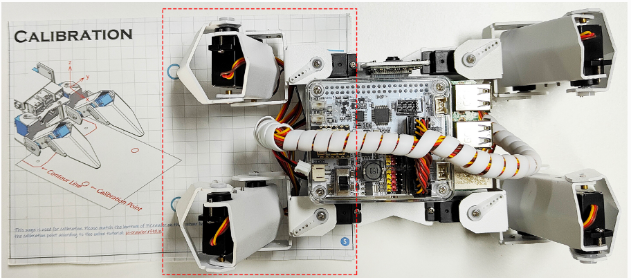

  4. Now, change the calibration paper to the right and press the 1 and 4 keys to choose right 2 legs, then press w, a, s, d, r, and f keys to move them to the calibration point.
    ../../_images/calibration41.png
