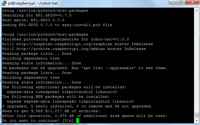

Running setup.py will download some necessary components. You may fail to download due to network problems. You may need to download again at this time. In the following cases, enter Y and press Enter.
../../_images/dowload_code.png

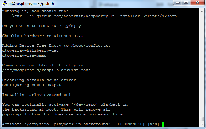

Type y and press Enter to continue running the script.
../../_images/i2s2.png
Type y and press Enter to run /dev/zero in the background.

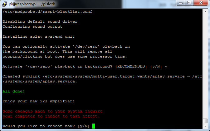

../../_images/i2s3.png
Type y and press Enter to restart the machine.
If there is no sound after restarting, you may need to run the i2samp.sh script multiple times.
