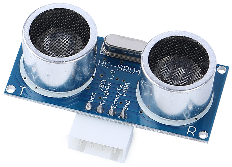

Let’s get to know the HC-SR04, a powerful ultrasonic distance sensor. This tiny device can accurately measure distances from 2 cm up to 400 cm, all without touching a thing! Amazing, right? It’s like having a superhero power! It can “see” the distances just by using sound waves, like how a bat navigates at night.
It uses four superpowers, or rather, four pins to do its magic:
../_images/ultrasonic_pic.png
  • TRIG (Trigger Pulse Input) - It’s the start button for our superhero. It tells our superhero, “Hey, it’s time to send out a super sonic wave!”
  • ECHO (Echo Pulse Output) - This is how our superhero listens to the echo of the sound wave it sent out.
  • VCC - Even superheroes need some energy. We connect it to a 5V power supply.
  • GND - It’s the ground connection. Just like how superheroes need to stay connected to reality!

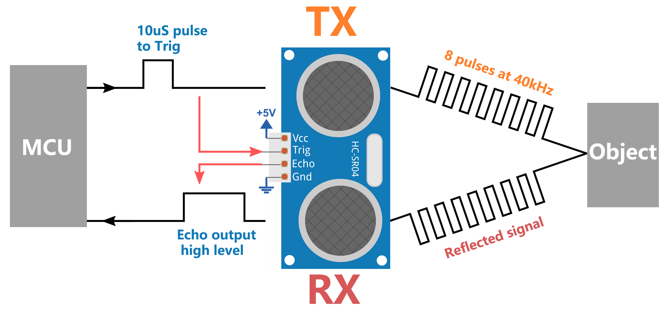

Imagine our superhero, the HC-SR04 Ultrasonic Sensor, playing a game of echo in the mountains.
../_images/ultrasonic_prin.jpg
  • First, our superhero’s brain, the MCU, says, “Ready, Set, Go!” by sending out a high-level signal for at least 10 microseconds to our superhero. This is like when we gather our energy before we yell into a valley.
  • On hearing “Go!”, our superhero shouts out loud 8 times very quickly. This super-sonic shout is sent out at a speed of 40 kHz. The superhero also starts a stopwatch and keeps an ear out for any returning shouts.
  • If there is an obstacle in front, the shout will hit it and echo back. On hearing the echo, our superhero stops the stopwatch and notes the time. It also sends out a high-level signal to let the MCU know it heard an echo.
  • Lastly, to find out how far away the obstacle is, our superhero uses a simple formula. It takes the time it recorded on the stopwatch, divides it by 2, and multiplies it by the speed of sound (340m/s). The result is the distance to the obstacle!

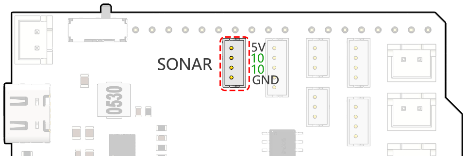

  • We have connected both the TRIG and ECHO pins to pin 10 on the GalaxyRVR Shield. This allows us to control both signal transmission and reception of the ultrasonic module using a single Arduino pin.

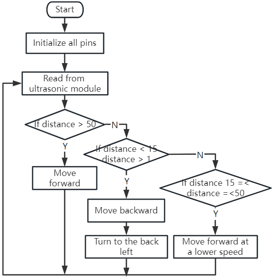

  • In the loop() function, we call readSensorData() and stores its returned value in the distance variable.
    float distance = readSensorData();
  • Depending on this distance, the Rover will move forward, move backward, or stop.
    // Control rover based on distance reading
    if (distance > 50) {  // If it's safe to move forward
      moveForward(200);
    } else if (distance < 15) {  // If there's an obstacle close
      moveBackward(200);
      delay(500);  // Wait for a while before attempting to turn
      backLeft(150);
      delay(1000);
    } else {  // For distances in between, proceed with caution
      moveForward(150);
    • If the path is clear (the obstacle is more than 50 cm away), our Rover boldly moves forward.
    • And if an obstacle is getting close (less than 50 cm but more than 15 cm away), our Rover will move forward at a lower speed.
    • If an obstacle is too close for comfort (less than 15 cm away), the Mars rover will move backward and then turn to the left.
