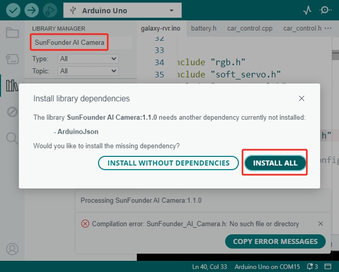

2. Compilation error: SoftPWM.h or SunFounder_AI_Camera.h: No such file or directory?
If you get a “Compilation error: SoftPWM.h: No such file or directory” prompt, it means you don’t have the SoftPWM library installed.
Please install the two required libraries SoftPWM and SunFounder AI Camera as shown.
For the SunFounder AI Camera library, you need to select “INSTALL ALL” to simultaneously install the required ArduinoJson dependency.

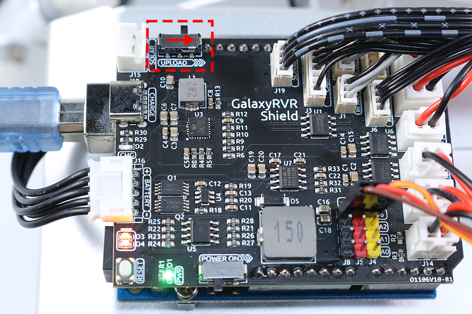

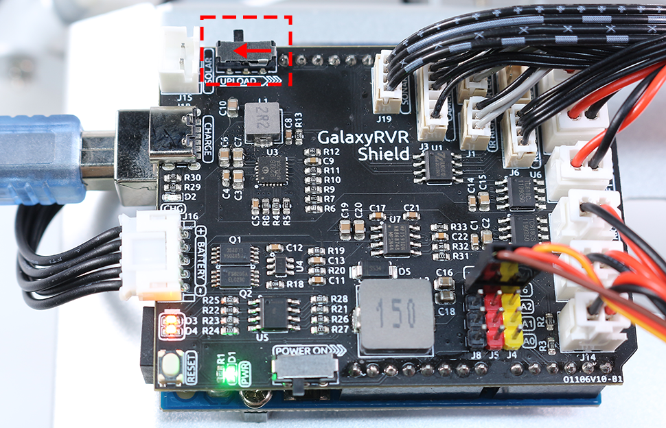

At this point, you need to make sure that the ESP32 CAM is unplugged.
The ESP32-CAM and the Arduino board share the same RX (receive) and TX (transmit) pins. So, before you’re uploading code, you’ll need to first disconnect the ESP32-CAM to avoid any conflicts or potential issues.
After the code is successfully uploaded, if you need to use the ESP32 CAM, then you need to move the switch to the left to start the ESP32 CAM.

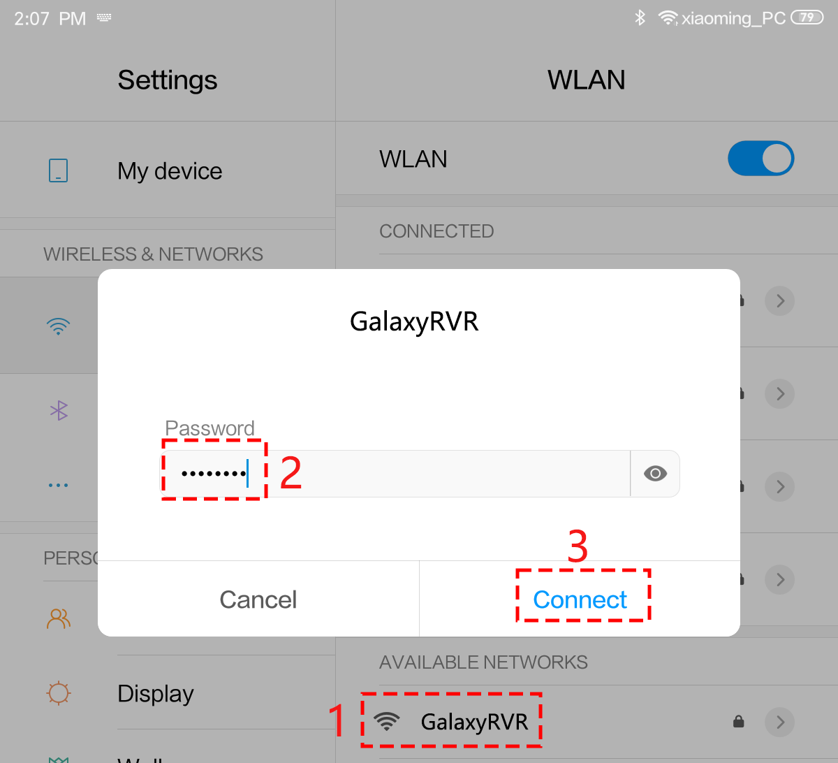

  2. Connect your mobile device to the GalaxyRVR’s WiFi network.
    • The network name (SSID) is GalaxyRVR and the password is 12345678.
    • If you see a warning stating “No Internet access,” please choose the option to “Stay connected.”

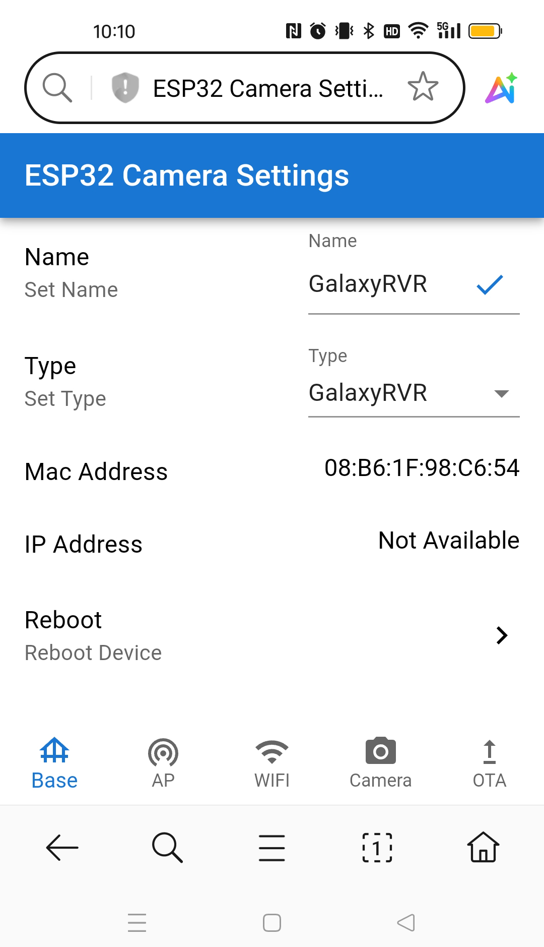

  3. Open a web browser on your mobile device and go to the address http://192.168.4.1. This will take you to the ESP32-CAM firmware update portal.

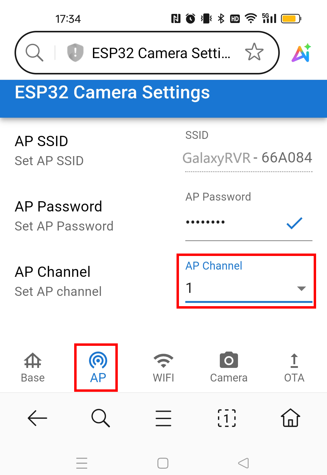

  4. Under the AP page, select a different channel.
    • The default channel is 1. When selecting a new channel, skip 1-2 channels at a time (e.g., from channel 1 to 3, and if needed, to 5).

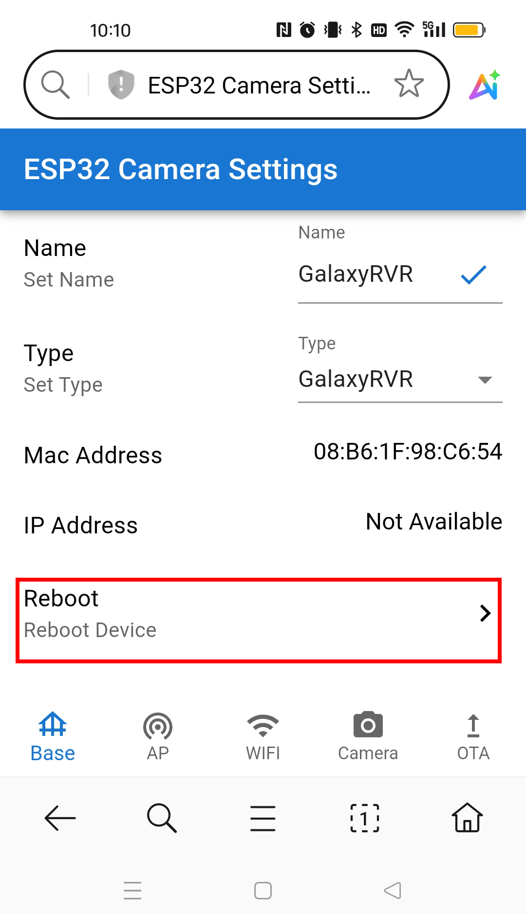

  5. Return to the Base page and click the Reboot button to restart the GalaxyRVR. The GalaxyRVR is now ready for normal operation.

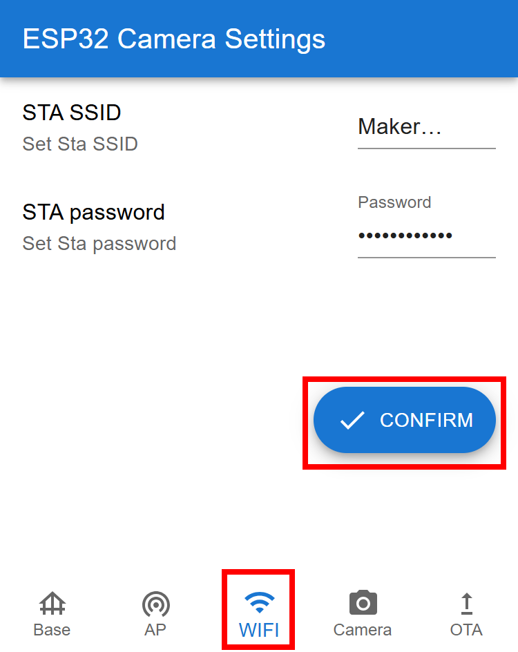

  4. Under the WiFi page, enter your home WiFi network name (SSID) and password.
    _images/faq_wifi.png
  5. Tap the CONFIRM button.
    • GalaxyRVR will attempt to connect to your home Wi-Fi.
    • If the connection is successful, the spinning icon will stop and a checkmark will appear.
  6. After rebooting, connect your mobile device to the same home Wi-Fi network.
  7. You can now connect to GalaxyRVR through the RoboPilot App or Mammoth Coding.
