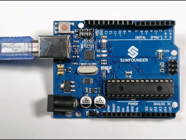

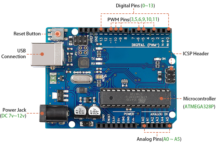

Getting to Know Your SunFounder R3 Board
Inside your kit, you’ll find a blue board, seemingly a tiny city filled with small metallic towers and pathways. But don’t let it intimidate you! This is the SunFounder R3 development board, a kind of Arduino board that can be used to program and control a vast array of electronic devices and projects.
Let’s understand its key features in simple terms:
../_images/sf_r3.jpg
  • 14 Digital Pins: Think of these pins like little messengers. They can be programmed to send (output) or receive (input) simple “yes” or “no” messages to other parts of your Mars Rover. These messages are actually “on” or “off” signals that the board uses to control things like lights or motors.
    • Six of these special pins can even send messages in a kind of secret code called PWM (Pulse Width Modulation). This code can be used to control how bright a light is, how fast a motor spins, or even where a moving part positions itself.
  • 6 Analog Pins: These pins are like the board’s six special senses. They can read signals from different types of sensors (like a temperature sensor) and then translate these signals into a language that the board can understand and use in its programming.
  • USB Connection: This is like the board’s umbilical cord. You can use it to connect your board to your computer. This connection allows your computer to “teach” the board what to do by sending it a program you write.
  • Power Jack: This is the board’s food supply. You can connect a power supply, like a battery or an AC-to-DC adapter, to this jack to “feed” your board the electricity it needs to work.
  • ICSP Header: This is like a special entrance for programming the board. It can be used if you have an external programmer (a special device for “teaching” the board).
  • Reset Button: If you press it, it’s like telling the board to forget what it was just doing and start its program over from the beginning.
With these basics, you’ll be all set to begin your programming adventures with the SunFounder R3 board!

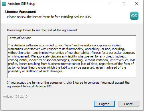

  2. You’ll be shown the License Agreement. Take a moment to read through this, and if you agree to the terms, click “I Agree”.
    ../_images/sp_002.png

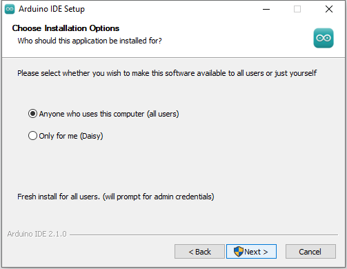

  3. Next, you’ll be asked to choose installation options. Leave these as they are and click “Next”.
    ../_images/sp_003.png

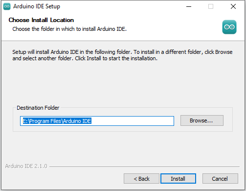

  4. Choose where you want to install the software. It’s generally best to install it on a different drive than the one your system uses.
    ../_images/sp_004.png

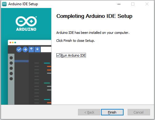

  5. Click “Install” to start the installation. Once it’s done, click “Finish”.
    ../_images/sp_005.png

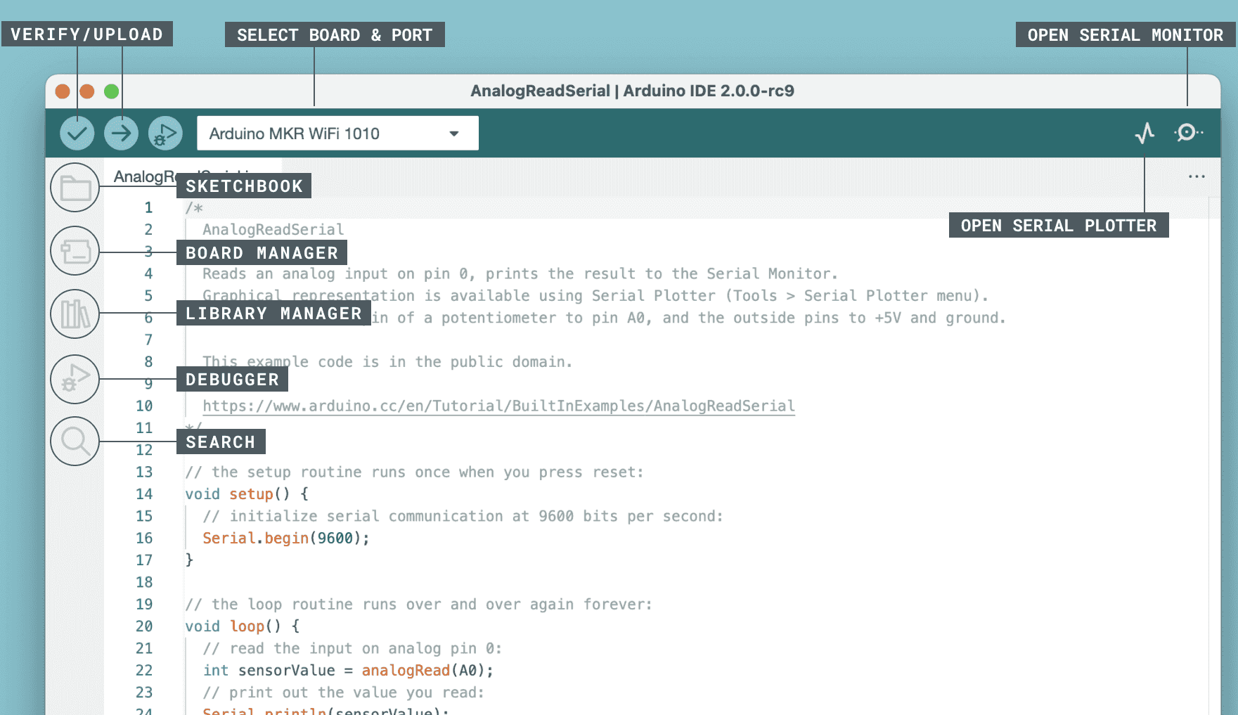

Discovering the Arduino Playground (IDE)
Let’s imagine together that the Arduino IDE is a magical playground filled with tools and gadgets waiting for us to explore and play with. Up next, I will guide you to understand every corner of this playground.
../_images/ide-2-overview.png
Here’s what you’ll find in your playground:
  • Verify / Upload - Imagine this as your magic elevator. It takes the code you’ve written and whisks it up into your Arduino board.
  • Select Board & Port - This is your treasure map. It automatically shows the Arduino boards you’ve plugged into your computer, and tells you their port number.
  • Sketchbook - This is your personal library. It’s where all your sketches (programs) are stored on your computer. Plus, it can connect to the Arduino Cloud, so you can fetch your sketches from the online world too.
  • Boards Manager - Think of this as your toolkit. It’s where you can find and install different packages for your Arduino.
  • Library Manager - This is your endless treasure chest. Thousands of libraries made by Arduino and its community are waiting for you here. Need a tool or material for your code? Dive in and find it!
  • Debugger - Imagine you had a superpower that let you test and debug your code in real time, finding and fixing problems as they happen. That’s what this is!
  • Search - Think of this as your magnifying glass. It helps you search for keywords in your code.
  • Open Serial Monitor - This is like your communicator device. It opens a new tab that lets your computer and Arduino board send messages back and forth.

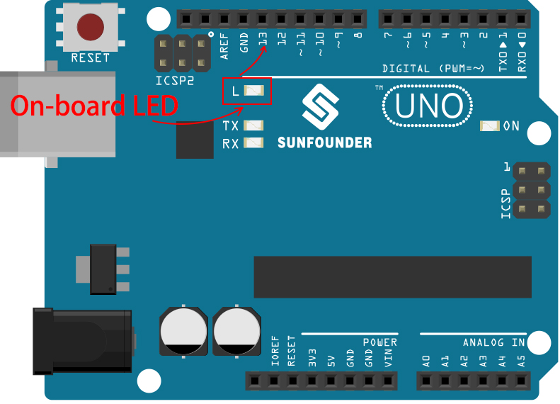

Alright, it’s time to have some fun! We’re going to make an LED blink - it’s like saying “Hello, World!” in the world of Arduino.
Most Arduino boards have a built-in LED on pin 13, which makes this a good first experiment.
../_images/1_led.jpg

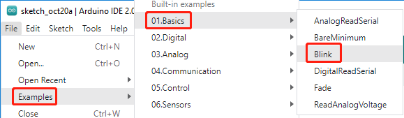

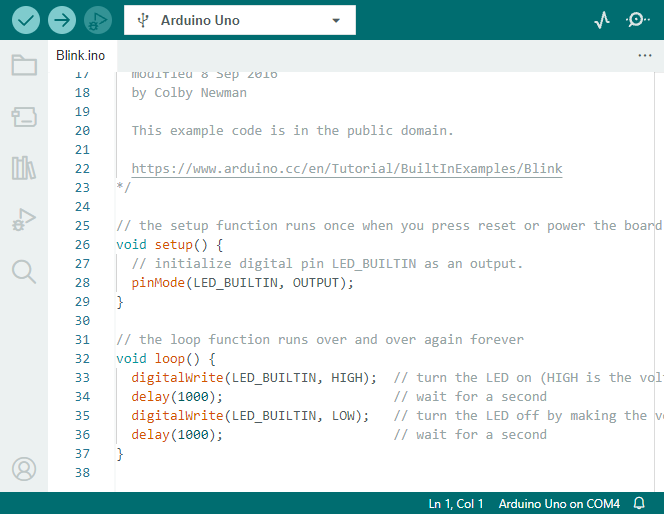

  2. Find the example sketch: On the Arduino IDE, go to File -> Examples -> Basic -> Blink. What you see that pops up is a ready-to-use program that we’re going to modify. It’s like getting a ready-made cake that we’re about to decorate!
    ../_images/open_blink.png

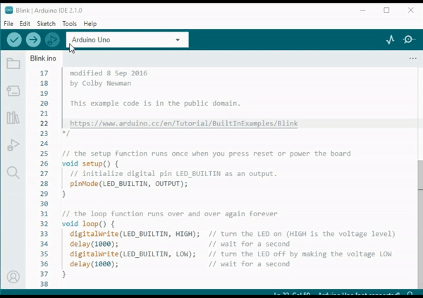

  3. Understand the sketch: Look at the code in this new window. It tells Arduino to turn on the built-in LED (which is on pin 13) for one second, then turn it off for one second, and then repeat. It’s like sending Morse code, but with light!
    ../_images/led_blink.png

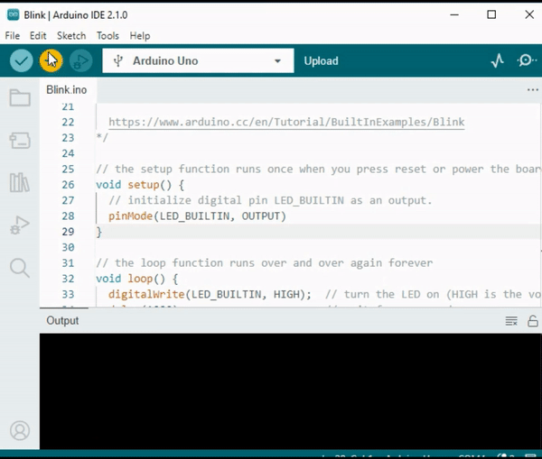

  4. Upload the sketch: Once you’ve selected the correct board and port, just click the upload button. It’s as easy as sending a letter; you’re delivering your instructions to the Arduino board! Most of the time, the system will automatically detect the board and port for you.
    ../_images/upload_blink.gif
  5. Watch it work: If all goes well, you’ll see the LED on your Arduino board start to blink on and off. It’s like your Arduino is winking at you!
    ../_images/blink_led.gif
You’ve done a great job! You’ve just run your first Arduino program, making you a bona fide programmer! So what’s next? We’re just scratching the surface of what Arduino can do. Ready for the next challenge?

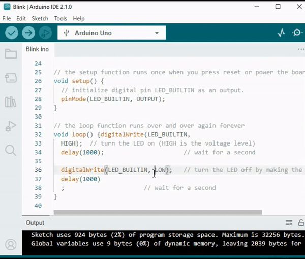

  • Punctuation Marks in Coding
    Just like in a storybook, Arduino uses special punctuation marks to make sense of the code:
    • Semicolons (;): These are like the full stops in a story. They tell the Arduino “Okay, I’m done with this action. What’s next?”
    • Curly Braces {}: These are like the beginning and the end of a chapter. They wrap up pieces of code together, marking where a section starts and ends.
    If you happen to forget some of these punctuation marks, don’t worry! The Arduino is like a friendly teacher who will check your work, point out where the mistakes are, and show you how to fix them. It’s all part of the learning adventure!
    ../_images/blink_error.gif

  • Code Readability: Making Code Friendly
    While you can write your code in any manner you want (for example, placing semicolons on a separate line won’t cause any errors), it’s important to keep in mind the readability of the code.
    ../_images/blink_noerror.gif
