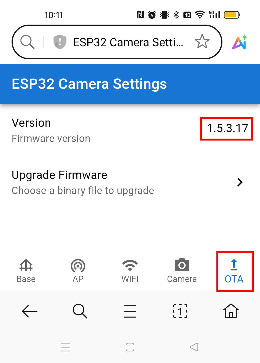

  5. Open a web browser on your mobile device and go to the address http://192.168.4.1. This will take you to the ESP32-CAM firmware update portal.
    _images/firmware_access.jpg
  6. On the OTA page, check the current firmware version displayed on the webpage.
    • If your version number is higher than 1.5.1, an update is not required. You can skip the remaining steps and proceed directly to Quick Start.
    • If the version is 1.5.1 or lower, please continue with the update.
    _images/firmware_version.jpg

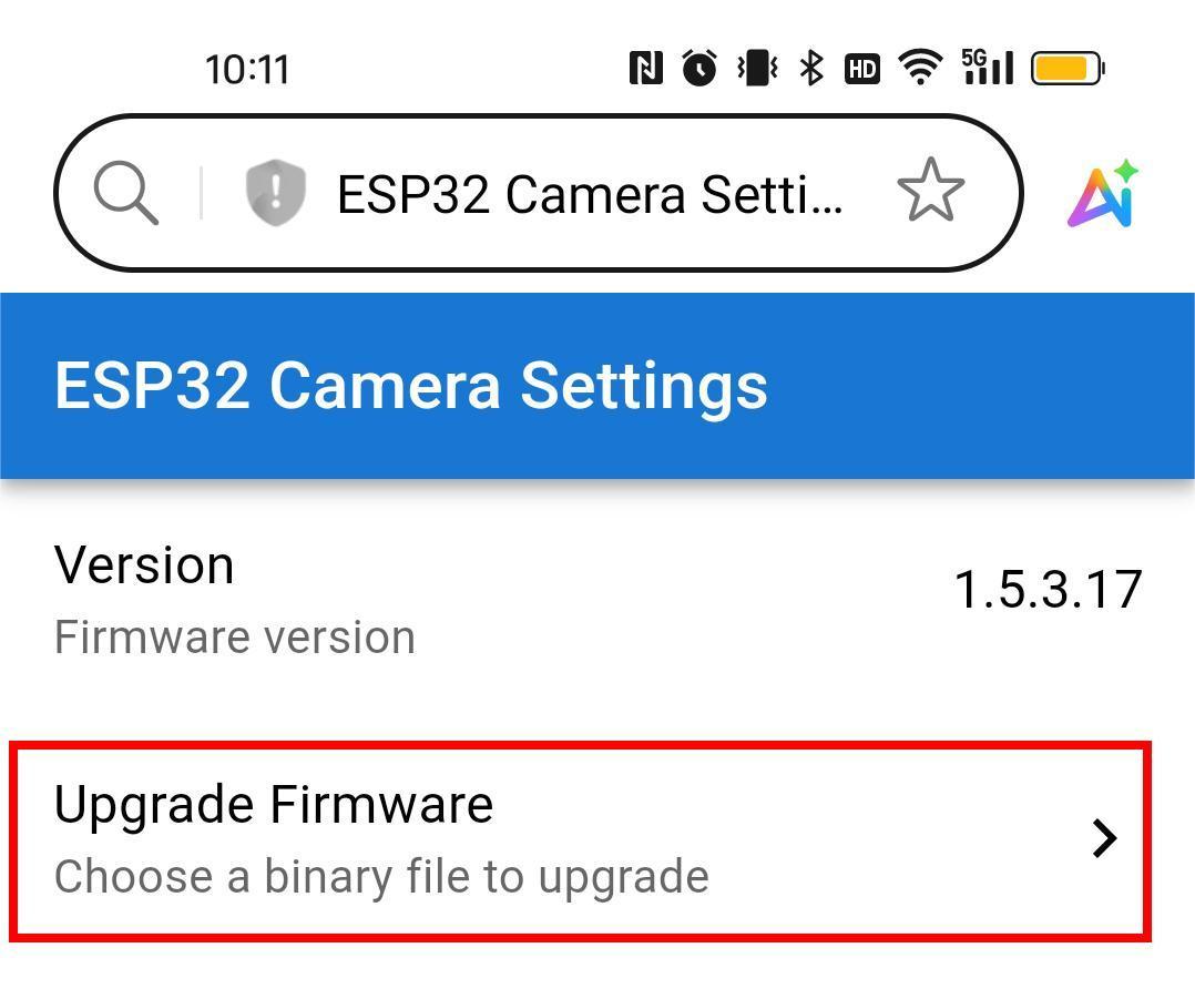

  7. Tap the Upgrade Firmware button.
    _images/firmware_tap.jpg

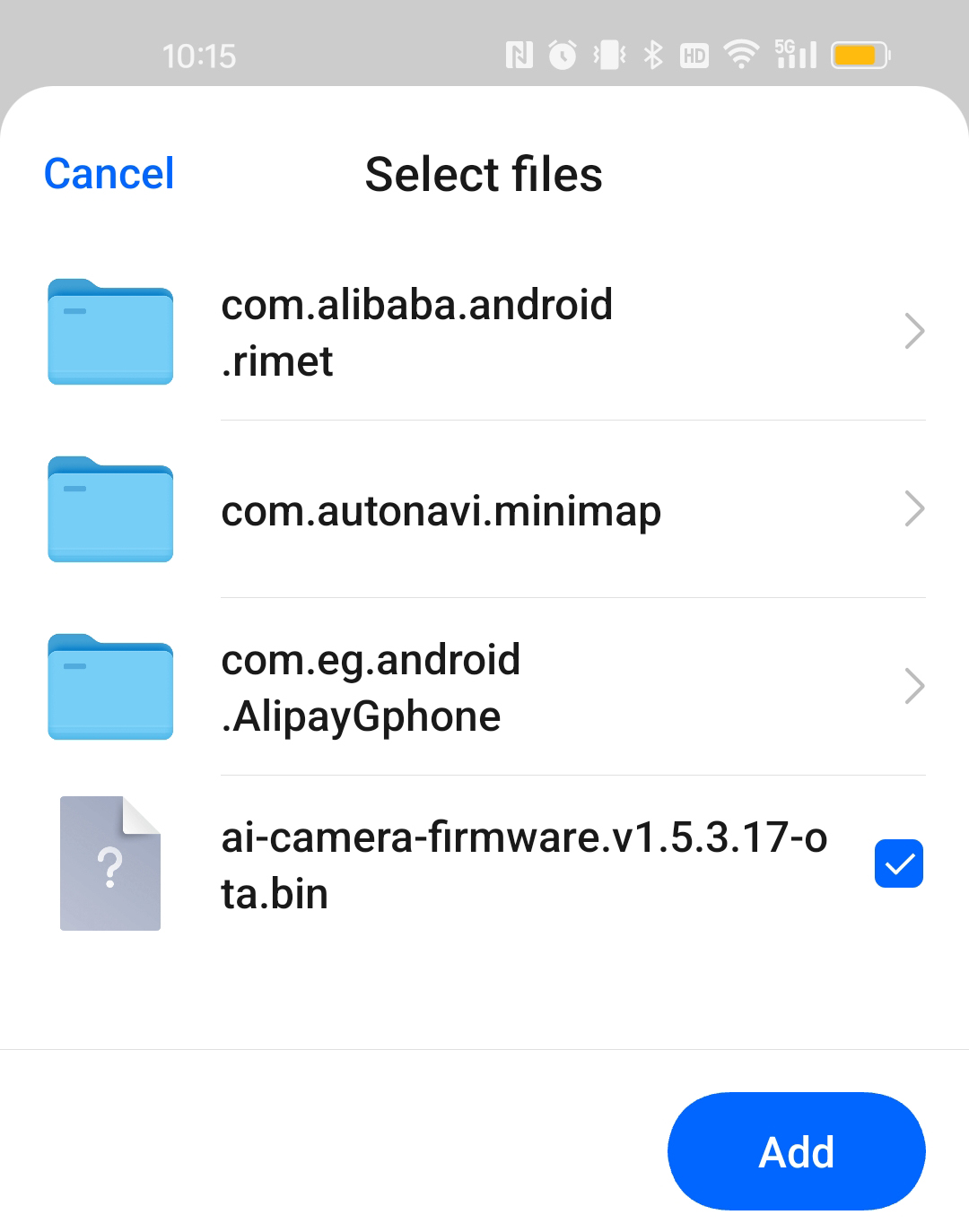

  8. A file selection dialog will appear. Navigate to and select the ai-camera-firware.ino.x.x.x.bin file you transferred to your mobile device earlier.
    _images/firmware_select.jpg

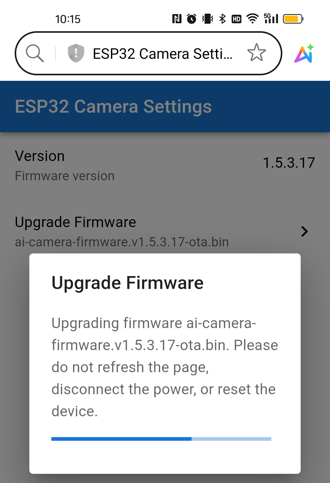

  9. The firmware update will begin immediately after you select the file.
    _images/firmware_upgrade.jpg

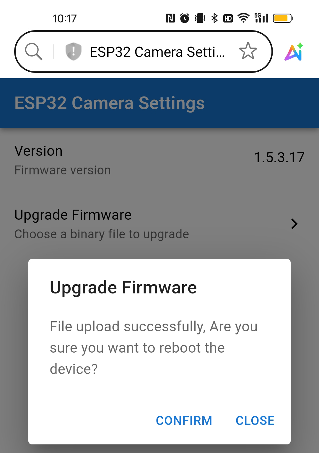

  10. Wait for the firmware upgrade to complete.
    • The upload process typically takes 1-2 minutes. Once finished, a success message will appear in a pop-up window.
    • You can then select CONFIRM to restart the GalaxyRVR or CLOSE to dismiss the window.
    _images/firmware_finish.jpg

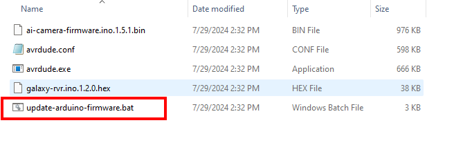

  2. Check whether the firmware files have been downloaded.
  3. Run the update script
    • Open the galaxy-rvr-1.2.0 folder (downloaded and installed in the previous step).
    • Double-click the update-arduino-firmware.bat script.
    • A command prompt window will appear automatically.
    _images/faq_bat_file.png

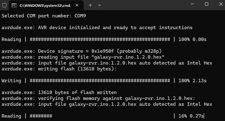

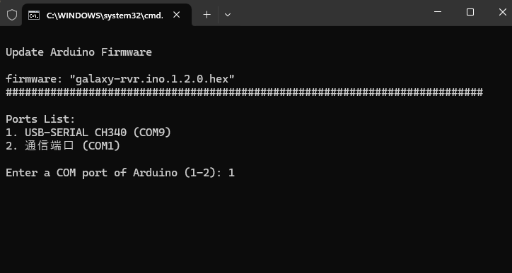

  4. Select the serial port and upload
    • In the command prompt, a list of available serial ports will be displayed.
    • Enter the sequence number shown on the left to select the Arduino Uno’s serial port.
    • Press Enter to begin the automatic upload.
    • Example: If the list shows 1 USB-SERIALXXX (COMxx), enter 1 and press Enter.
    _images/faq_select_com.png
  5. After waiting for the upload to complete, you can unplug the USB cable.
    _images/faq_uno_updating.png
