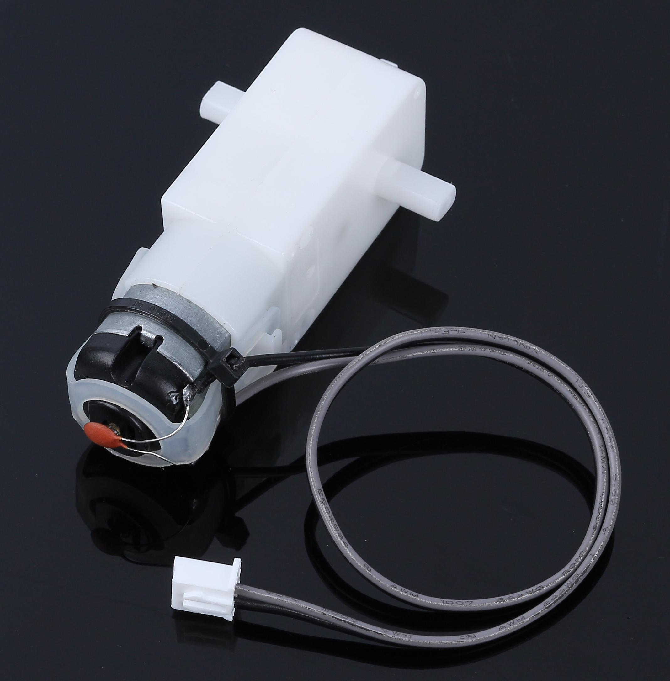

The type of motor we’re focusing on in our GalaxyRVR is a specific kind called a TT Gear Motor.
../_images/tt_motor_xh.jpg

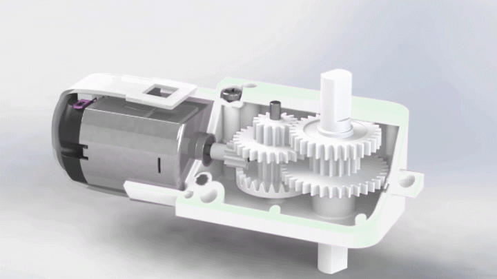

This is essentially a regular motor combined with a series of gears, all encased within a plastic shell.
As the motor spins, the gears translate this spin to the wheels of our rover. The use of gears provides a crucial benefit - it increases torque, enabling the motor to move larger, heavier loads.
../_images/motor_internal.gif
Isn’t it fascinating to see how science and engineering principles come to life? Motors are a perfect example of these principles in action. By understanding how motors work, we can dream up and invent a wide array of machines. Let’s dive deeper into the world of motors and unleash our creativity!

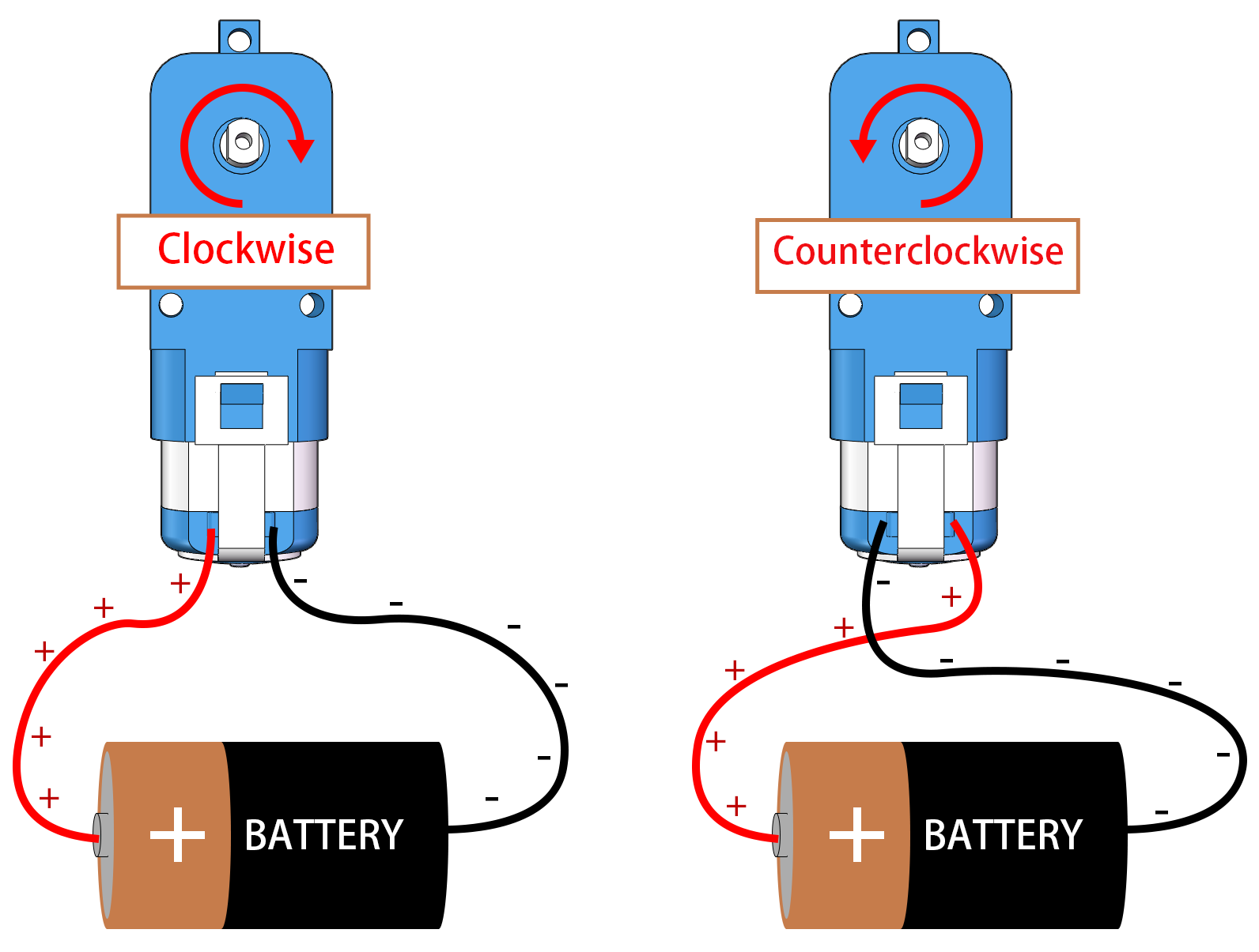

Consider a simple experiment where we connect a motor directly to a battery. The current from the battery flows into the motor, triggering the internal mechanism of the motor to start spinning. This spinning action is due to the magnetic forces inside the motor.
../_images/motor_battery.png
Interestingly, if you reverse the connections to the battery, the motor spins in the opposite direction! This happens because the direction of current flow changes, altering the direction of the magnetic field and consequently the direction of the motor’s spin.

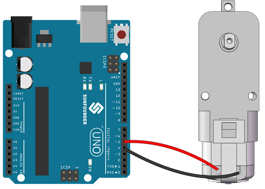

Now we know that connecting the motor directly to a battery can make it spin, but often we want to control its movement with code, so we include an Arduino board between them. But what would happen if we tried to connect the motor directly to the signal pins on the Arduino board?
../_images/motor_uno.png
If you guessed that the motor would not spin, you are correct! But why is that so?
The answer lies in the current output of the Arduino board. The signal pins on a typical Arduino board can output only about 20mA of current, which is insufficient to drive a motor.

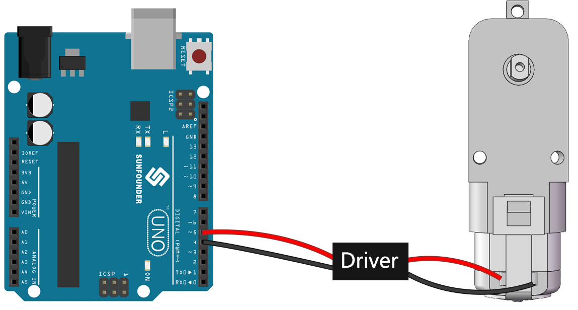

So, how can we control motors using our Arduino? This is where a crucial component comes into the picture - a motor driver. Think of a motor driver as a bridge between the Arduino and the motor. It takes the low-current control signal from the Arduino, amplifies it, and sends it to the motor, thus enabling the motor to spin.
../_images/motor_uno2.png
In our next step, we’ll dive into the specifics of the motor driver and understand how we can effectively use it with our Arduino board to control a motor. Stay tuned for more exciting learning!

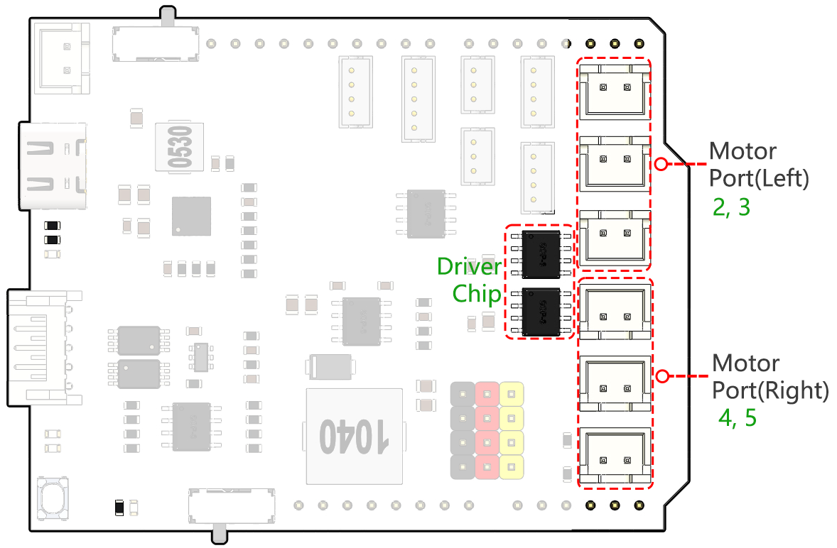

Our GalaxyRVR Shield, included in the kit, serves as the control center for our Mars Rover. It is the hub where we connect all our sensors, motors, and power supply. It consists of several components that allow us to control and power our Rover effectively.
On the right side of the shield, you’ll notice six motor ports. However, they are grouped into two sets, each controlled by a separate motor drive chip. Three ports marked “Left” are controlled by one chip, and the other three ports marked “Right” are controlled by another.
../_images/motor_shield.png

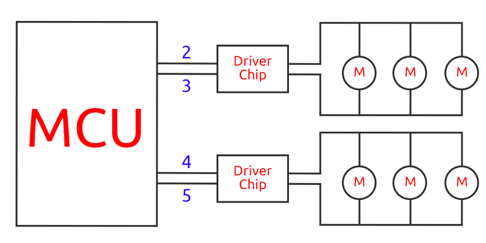

  • 3. About Circuit Internal Connection
    1. You can plug two more motors into the “Left” marked motor ports. You will see them rotate simultaneously.
    2. Now, let’s understand the simple principle of how the two drive chips control the six motors. Pins 2 and 3 on the Arduino board output signals to the motor drive chip, and the other end of the chip is connected to three motors in parallel. Similarly, pins 4 and 5 output signals to another drive chip, which in turn is connected to another three motors in parallel.
    3. If you want to test another drive chip, you just need to change the pins to 4 and 5.

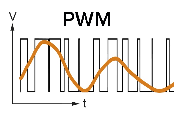

In the previous step, we controlled the motor’s direction by simply setting its pins HIGH or LOW. This is like giving the motor full power to drive it, similar to pressing the accelerator pedal to the floor in a car. But in many situations, we might want to adjust the motor speed to suit different scenarios, just like we adjust the speed of a car depending on whether we’re driving in a city or on a highway. This is where Pulse Width Modulation (PWM) comes in.
../_images/motor_pwm.jpg
PWM is a technique used to create the effect of variable voltage output by rapidly switching the output between HIGH and LOW. With PWM, we can simulate the effect of an analogue signal while only actually outputting digital signals.
You might be finding this hard to understand, and that’s okay! We’ll be learning how to adjust motor speed using PWM through coding in the following sections.
Note that although the SunFounder R3 board has some pins with built-in PWM functionality, we can’t use them for our motor because they’re already serving other functions. Thus, we’re connecting the driver chips to pins 2, 3, 4, and 5, and using the Arduino’s SoftPWM library to enable PWM on these pins.
