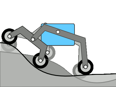

The Rocker-Bogie system is like a mountain goat of mechanics - designed to keep all wheels of the rover grounded while it navigates over rough and rocky terrains. It’s specially built for handling Mars’ unpredictable landscape, including steep inclines and sizable boulders. This system skips springs and instead leverages the geometry of its six wheels and their interactions to conquer tricky terrain. It’s a shining example of how clever mechanical design can surmount environmental hurdles.

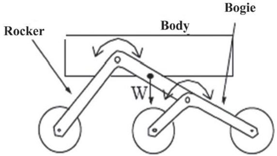

Let’s dive into the two main parts of this system - the “rocker” and the “bogie”.
../_images/rocker_bogie.png
  • The “rocker” part of the system is like the two large limbs on either side of the rover’s body. These limbs, or rockers, connect to each other and the rover’s body, or chassis, through a mechanism called a differential. Just like two legs walking, the rockers rotate in opposite directions relative to the chassis, making sure that most of the wheels keep in contact with the ground. The body of the rover maintains the average angle of both rockers. One end of a rocker connects to a wheel, while the other end connects to the bogie.
  • The “bogie” part of the system is like a mini-limbed creature attached to the rocker. It’s a smaller linkage system that pivots in the middle to the rocker and has a wheel at both ends.

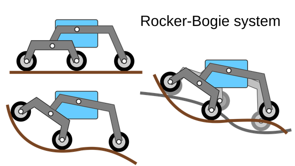

Step 2: Seeing the System in Action
Below is a GIF that showcases the unique features of the Rocker-Bogie suspension system and illustrates how it enables Mars rovers to navigate the challenging Martian terrain.
../_images/rocker_bogie.gif

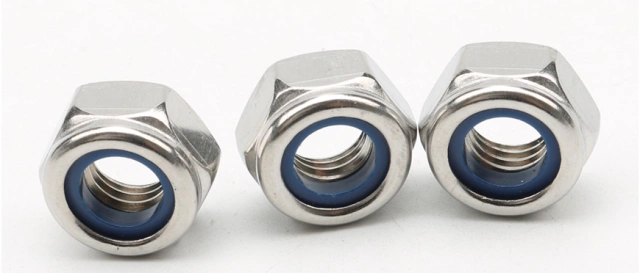

During the assembly of the suspension system, did you notice that all the moving parts utilize self-locking nuts? Have you ever wondered why?
../_images/self_locking_nuts.webp
Self-locking nuts are a type of fastener that includes a rubber ring inside a regular nut. This design ensures that the assembled parts won’t easily loosen and fall off due to vibrations during movement.
In addition, it also ensures that the parts can rotate within a certain range.
So during assembly, you need to tighten the screw and self-locking nut with a socket and screwdriver first, then loosen it a bit. This ensures that there’s room for free rotation between the parts without them being too loose.
