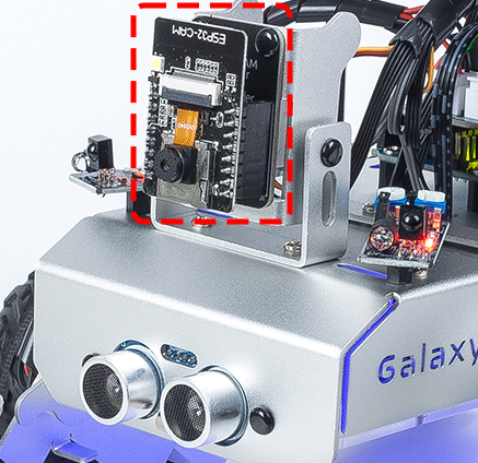

  • When inserting the ESP32 CAM into the Camera Adapter, be aware of its orientation. It should align properly with the ESP32 Adapter.

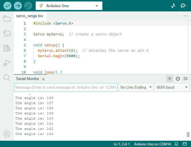

We use a for loop to rotate the servo from 0 to 180 degrees while keeping a note of the angle in the Serial Monitor.
  • The ESP32-CAM and the Arduino board share the same RX (receive) and TX (transmit) pins. So, before uploading the code, you’ll need to first release the ESP32-CAM by slide this switch to right side to avoid any conflicts or potential issues.
  • After we upload this code, open the Serial Monitor. If no information appears, press the Reset button on the GalaxyRVR shield to run the code again.
  • You will see the servo rotate, and the Serial Monitor will display the angle.
../_images/servo_range.png
On my Rover, the tilt mechanism could go up to around 135° before it hit the body of the Rover and couldn’t go any further.
