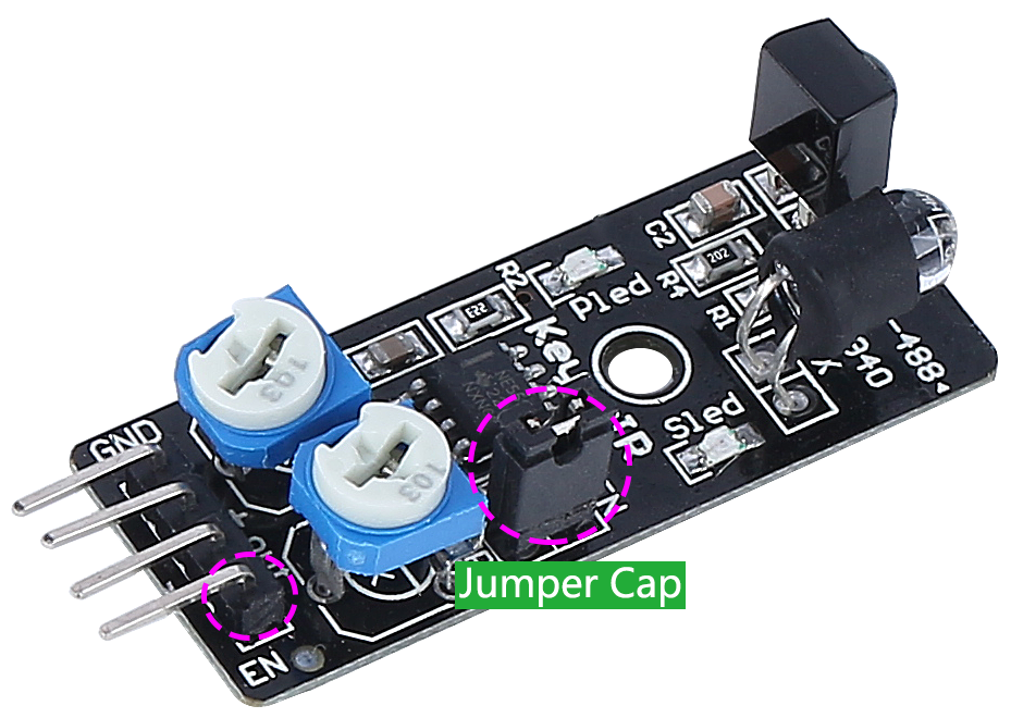

The EN pin’s low-level state activates the module, with the jumper cap securing the EN pin to the GND. If you wish to control the EN pin via code, the jumper cap needs to be removed.
../_images/ir_cap.png

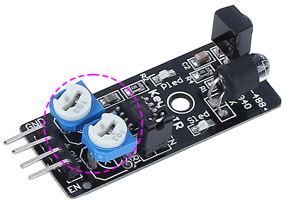

There are two potentiometers on the module, one for adjusting the transmitting power and one for adjusting the transmitting frequency, and by adjusting these two potentiometers you can adjust its effective distance.
../_images/ir_avoid_pot.png

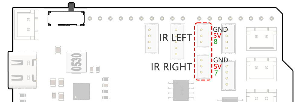

  1. Our Mars Rover is equipped with two special ā€œAlien-Eyeā€ sensors, perched neatly on pins 7 (right) and 8 (left). These ā€œAlien-Eyeā€ sensors are actually our infrared obstacle avoidance modules, always vigilant to dodge any ā€œspace rocksā€ (obstacles) in our Rover’s interstellar journey!
    ../_images/ir_shield.png

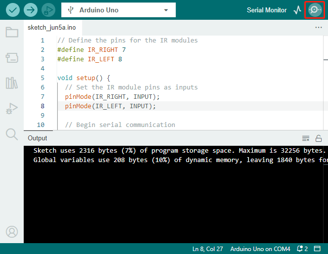

  3. Once your code is ready, select the correct board and port, and beam up the code to your Mars Rover. Then, tune into our secret communication line (the Serial Monitor) by clicking on its icon in the top right corner.
    ../_images/ir_open_serial.png

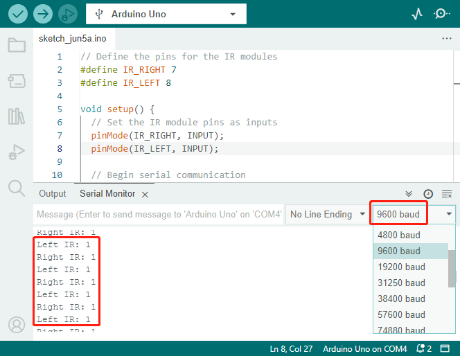

  4. Before you start receiving the Rover’s messages, make sure your secret communication line is tuned at the same speed (9600 baud) as your Rover. And there you have it - live updates from your Mars Rover!
    ../_images/ir_serial.png
  5. To put our system to the test, wave a ā€œspace rockā€ (your hand) in front of one of the sensors. You’ll see the value flip to 0, and the corresponding LED on the module lights up. That’s the Rover saying, ā€œLook out, space rock on my right!ā€
    Right IR: 0
    Left IR: 1
    Right IR: 0
    Left IR: 1
    Right IR: 0
    Left IR: 1

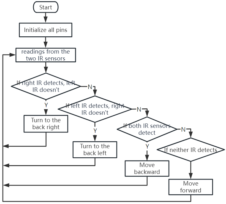

Here’s our plan: If the right sensor detects an obstacle, the Rover will turn to the back right. If the left sensor detects an obstacle, the Rover will turn to the back left. If both sensors detect an obstacle, the Rover will move backward. If no obstacles are detected, the Rover will continue moving straight ahead.
Let’s visualize this in a flowchart to make it even more clear. Flowcharts are a great way to logically outline a plan, especially when it comes to programming!
../_images/ir_flowchart.png
