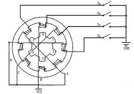

The stepper motor is a four-phase one, which uses a unipolarity DC power supply. As long as you electrify all phase windings of the motor by an appropriate timing sequence, you can make it rotate step by step. The schematic diagram of a four-phase reactive stepper motor:
../_images/image1291.png
In the figure, in the middle of the motor is a rotor - a gear-shaped permanent magnet. Around the rotor, 0 to 5 are teeth. Then more outside, there are 8 magnetic poles, with each two opposite ones connected by coil winding. So they form four pairs from A to D, which is called a phase. It has four lead wires to be connected with switches SA, SB, SC, and SD. Therefore, the four phases are in parallel in the circuit, and the two magnetic poles in one phase are in series.
Here’s how a 4-phase stepper motor works:
When switch SB is power on, switch SA, SC, and SD is power off, and B-phase magnetic poles align with tooth 0 and 3 of the rotor. At the same time, tooth 1 and 4 generate staggered teeth with C- and D-phase poles. Tooth 2 and 5 generate staggered teeth with D- and A-phase poles. When switch SC is power on, switch SB, SA, and SD is power off, the rotor rotates under magnetic field of C-phase winding and that between tooth 1 and 4. Then tooth 1 and 4 align with the magnetic poles of C-phase winding. While tooth 0 and 3 generate staggered teeth with A- and B-phase poles, and tooth 2 and 5 generate staggered teeth with the magnetic poles of A- and D-phase poles. The similar situation goes on and on. Energize the A, B, C and D phases in turn, and the rotor will rotate in the order of A, B, C and D.
../_images/image1301.png

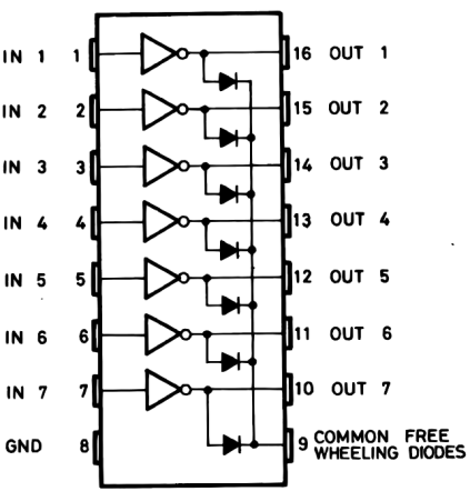

ULN2003
To apply the motor in the circuit, a driver board needs to be used. Stepper Motor Driver-ULN2003 is a 7-channel inverter circuit. That is, when the input pin is at high level, the output pin of ULN2003 is at low level, and vice versa. If we supply high level to IN1, and low level to IN2, IN3 and IN4, then the output end OUT1 is at low level, and all the other output ends are at high level.  The internal structure of the chip is shown as below.
../_images/image3381.png
The stepper motor driver constituted by ULN2003 chip and 4 LEDs is shown as follows. On the board, IN1,IN2,IN3 and IN4 work as input and the four LEDs, A, B, C, D are the indicators of input pin. In addition, OUT1,OUT2, OUT3 and OUT4 are connected to SA, SB, SC and SD on the stepper motor driver. When the value of IN1 is set to a high level, A lights up; switch SA is power on, and the stepper motor rotates one step. The similar case repeats on and on. Therefore, just give the stepper motor a specific timing sequence, it will rotate step by step. The ULN2003 here is used to provide particular timing sequences for the stepper motor.

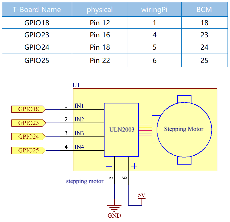

Schematic Diagram
../_images/image3391.png

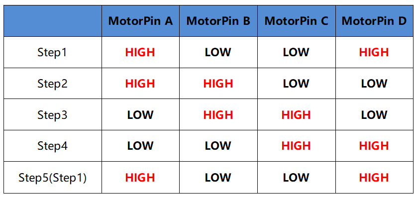

To make stepper motor rotate clockwise, level status of motorPin should is shown in the table below:
../_images/image3401.png
Therefore, potential write of MotorPin is implemented by using a two-layer of for loop.
In Step1, j=0, i=0~4.
motorPin[0] will be written in the high level(10011001&00001000=1)
motorPin[1] will be written in the low level(10011001&00000100=0)
motorPin[2] will be written in the low level(10011001&00000010=0)
motorPin[3] will be written in the high level(10011001&00000001=1)
In Step2, j=1, i=0~4.
motorPin[0] will be written in the high level(01001100&00001000=1)
motorPin[1] will be written in the low level(01001100&00000100=1)
and so on.

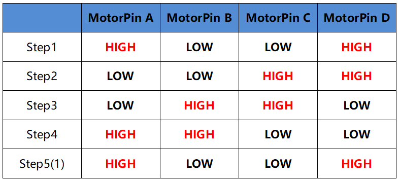

And to make the stepper motor rotate anti-clockwise, the level status of motorPin is shown in the following table.
../_images/image3411.png
motorPin[0] will be written in the high level(10011001&10000000=1)
motorPin[1] will be written in the low level(10011001&01000000=0)
In Step2,j=1, i=0~4.
motorPin[0] will be written in the high level(00110010&10000000=0)
motorPin[1] will be written in the low level(00110010&01000000=0)
