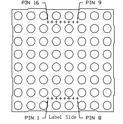

Generally, LED dot matrix can be categorized into two types: common cathode (CC) and common anode (CA). They look much alike, but internally the difference lies. You can tell by test. A CA one is used in this kit. You can see 788BS labeled at the side.
See the figure below. The pins are arranged at the two ends at the back. Take the label side for reference: pins on this end are pin 1-8, and oh the other are pin 9-16.
The external view:
../_images/image841.png
Below the figures show their internal structure. You can see in a CA LED dot matrix, ROW represents the anode of the LED, and COL is cathode; it’s contrary for a CC one. One thing in common: for both types, pin 13, 3, 4, 10, 6, 11, 15, and 16 are all COL, when pin 9, 14, 8, 12, 1, 7, 2, and 5 are all ROW. If you want to turn on the first LED at the top left corner, for a CA LED dot matrix, just set pin 9 as High and pin 13 as Low, and for a CC one, set pin 13 as High and pin 9 as Low. If you want to light up the whole first column, for CA, set pin 13 as Low and ROW 9, 14, 8, 12, 1, 7, 2, and 5 as High, when for CC, set pin 13 as High and ROW 9, 14, 8, 12, 1, 7, 2, and 5 as Low. Consider the following figures for better understanding.

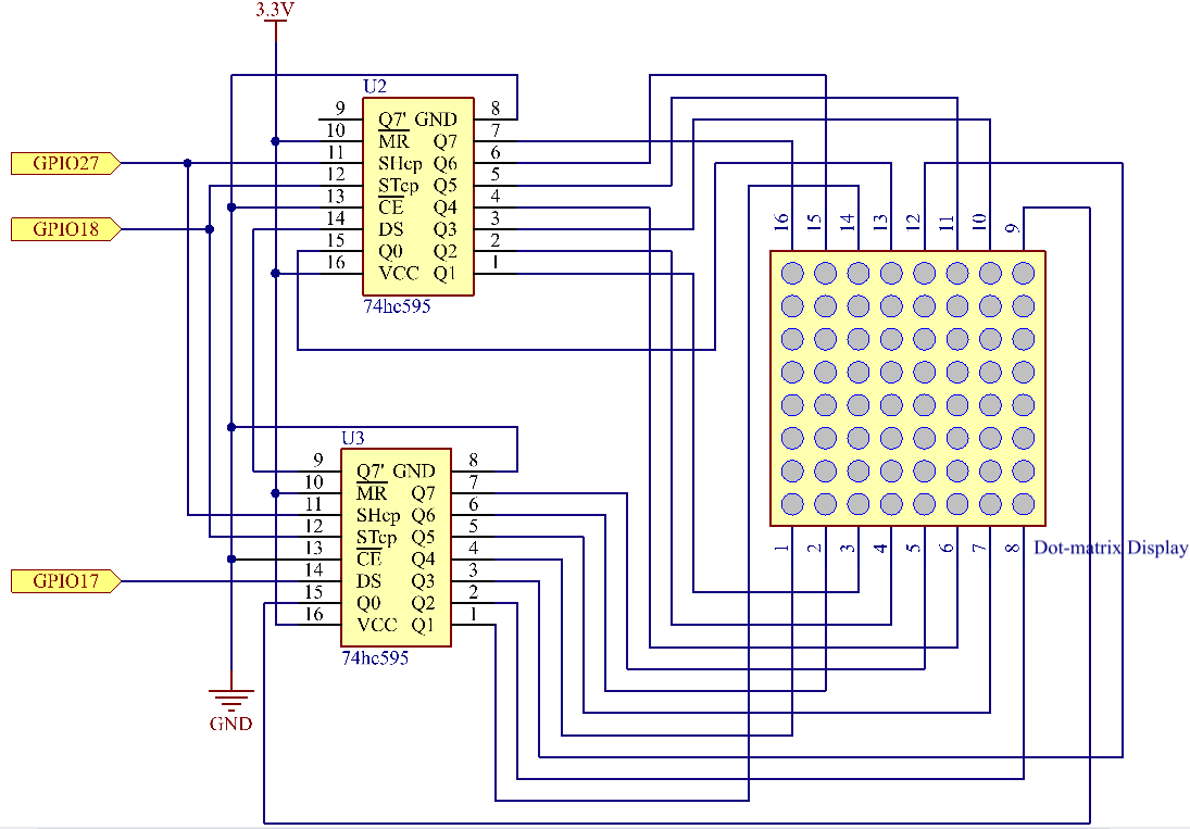

In addition, two 74HC595 chips are used here. One is to control the rows of the LED dot matrix while the other, the columns.

Step 2: Connect pin 11 of the two 74HC595 together, and then to GPIO27; then pin 12 of the two chips, and to GPIO18; next, pin 14 of the 74HC595 on the left side to GPIO17 and pin 9 to pin 14 of the second 74HC595.

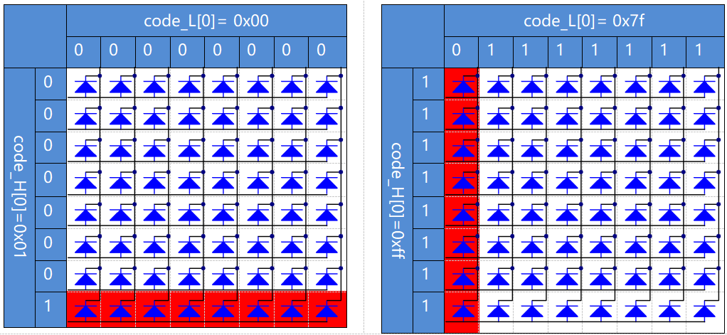

The array code_H represents the elements of the LED dot matrix row, and the array code_L refers to the elements of the column. When characters are displayed, an element in row and one in column are acquired and assigned to the two HC595 chips respectively. Thus a pattern is shown on the LED dot matrix. Take the first number of code_H, 0x01 and the first number of code_L, 0x00 as examples.
0x01 converted to binary becomes 00000001; 0x00 converted to binary becomes 0000 0000.
In this kit, common anode LED dot matrix display is applied, so only the eight LEDs in the eighth row light up. When the conditions that code H is 0xff and code_L is 0x7f are met simultaneously, these 8 LEDs in the first column are lit.
