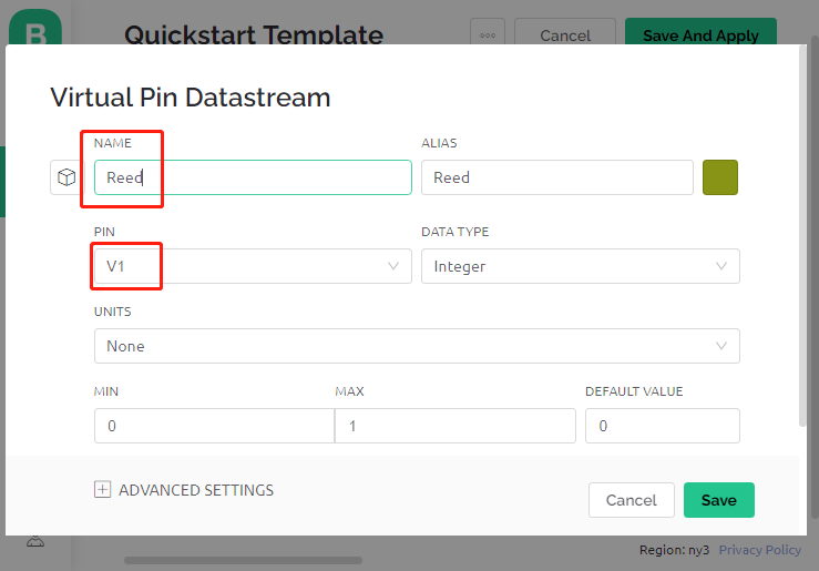

  1. Create a Datastream of type Virtual Pin in the Datastream page to get the value of Reed Switch. Set the DATA TYPE to Integer and MIN and MAX to 0 and 1.

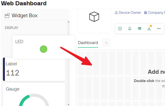

  2. Drag and drop an LED widget on the Wed Dashboard page, at a value of 1, it will light up (with color), otherwise it will be white.
